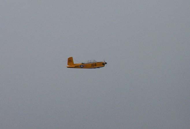

I have this plane and its one of my favorites. I have a Saito 72 in mine and it flies super. I don't think there is anyway to hide everything under the cowl because of the nosegear rails and equipment. The best way seems to be side mounted with the exhast down through the bottom with an extender.
