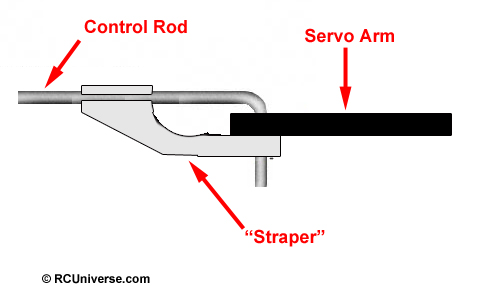

Hi everyone new to the hobbie and the forums can you guys tell me how the heck this thing attaches to my servo??
http://www.theworldmodels.com/para/p.../pl4112106.jpg
Is there a better way??
I am trying to complete a high wing sky raider.

Do use these connectors you need to create an "l-bend" in your control rod. This is simply a 90° bend in the control rod. You then use the keeper to keep it in place. See the attached diagram to clarify this. You can also find all the information you need concerning this at [link=http://www.airfieldmodels.com/information_source/model_aircraft_hardware/linkages.htm]Airfield Models[/link] . This site is ran by RCU member cafeenman and has a wealth of information on it. You can easily lose hours when you are on his site. Check it out, it should answer most of your questions.

the straper is slightly different. the WM version doesn't have two levels. bend the rod 90 degree angle then cut to length (be careful not to cut it too short). put the rod through the control horn then put it through the straper. attach the body of the straper to the rod. the keeper in this case would be the small section of fuel tubing.
be careful to cut the tubing cleanly or else it may break in flight. i've had a few times when it did break during flight... luckily, the straper stayed on. check the tubing each time before you fly to make sure they aren't ripping.

Is there a tool out there that makes clean bends or do you just "wing" it.
LOL
Ok that was bad but seriously,I just want to clarify. Does the arm on the straper go on top of the servo horn or bottom?
I assume it goes underneath and the fuel line holds the rod into the horn.

Ok, I'm a little more awake now. So let's see if I can do a better job of explaining this. First off, you really don't need a special tool to make the bend. Install the control rod on the surface it will attach too, turn on your radio, center your servo arm, lay the control rod over the servo arm, and mark where the L-bend will be. Then use a pair of pliers to hold the control rod at the mark you made and then bend the rest of the control rod so that you get a 90° bend in the rod.
Once you have the rod bent you now install the keeper. Put the L-bend through the hole in your servo arm. Then slide the keeper (straper) over the control rod that is sticking out of the bottom of the servo arm. Then you will "snap" the keep onto the control rod to keep it in place. See the attached diagram.

I was using the type of clip shown in RCKen's picture on my CG330 extreme with 3d control throws - the long arms on my servos pushed the clip off the 90 deg bend. I saw it while cleaning the plane - I got lucky - changed to other type clip. The clip in the first picture had the problem due to the large travel limits but mine snapped onto the bend - they came with the arf.
