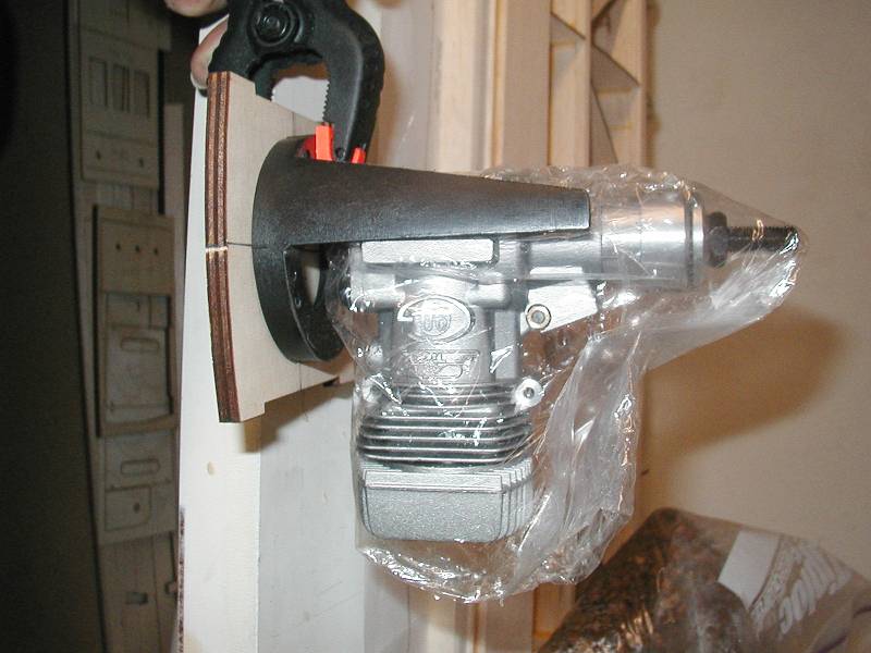

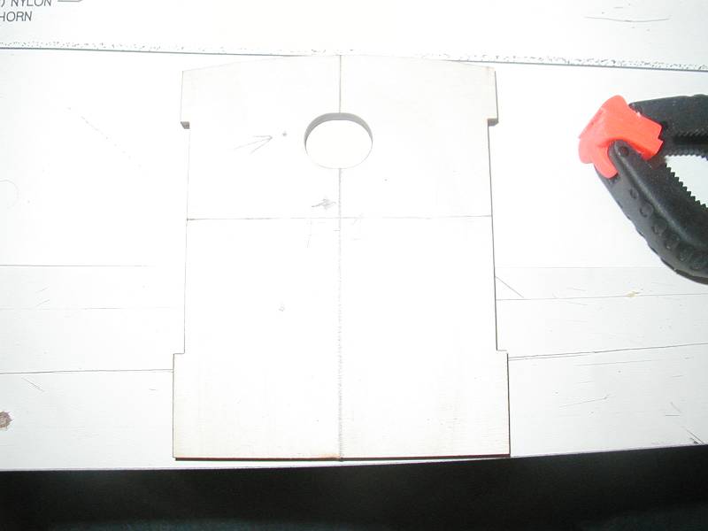

rfan_1: I have had plenty of issues with joining halves in the past to teach me to leave access to it, hehehe... thanks for the heads up though.

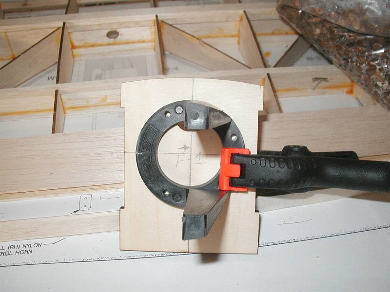

Okay, while I was waiting for the sheeting on the second wing half to dry, I started thinking about the firewall/mount. A little info: I am planning on attempting the foam plug -> plaster mold -> fiberglass cowl route to tidy up the front end of this plane and allow me to easily make new cowls if I change the exhaust from the ugly ST stock exhaust. I am using a Dave Brown 90FS mount with a Supertiger G90 engine. I have attached pictures of my preliminary layout. I am really not sure about how far out to mount the engine, but I am thinking I will hold off and try to get a little balance idea down the road before committing to drilling the engine mounting holes in the mount and shapeing the cowl plug.
Questions:
1) Does the top mounting hole location look like it will be too close to the fuel line hole (strength is the consideration I am thinking of)?
2) With the side mount engine, the carb will be lower. At what point do I need to measure the drop to readjust the tank floor? The carb venturi?
Questions:

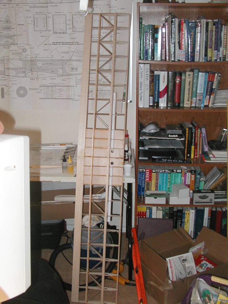

Well, I test fit the wing halves together with the dihedral brace today and.... WOW, did I get the root ribs a loooooot better this time round. There is about a 1/32" gap at the bottom of the ribs which could be 1/64th per root rib in error... I think that is perty good!
Got a thing to go to for my wifes work tonight, then I am flying in the morning, then I need to stop at the LHS and grab some 30 minute epoxy (don't trust myself with the 15 minute stuff I have now), and then I will join the halves tomorrow and post some more pics.

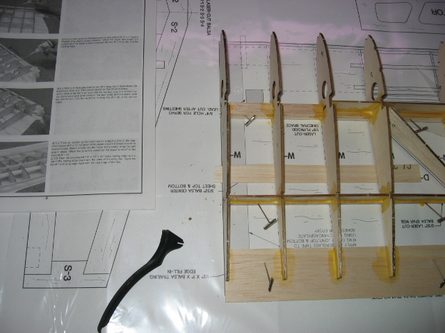

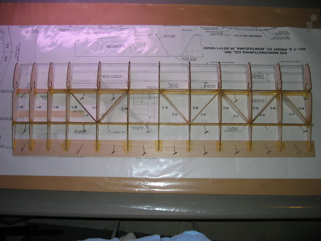

Mines going slower [&o] Finished gluing the right wing ribs and
spars with Titebond II today. And TRIED to get the root rib correct,
which I think I did for the most part. However, I found that the root
rib bows from top to bottom, so when I glue in the top spars I'll
straighten it out more to match the dual tool angle.
Building Note: For gluing, I tacked all the parts using thin CA and then used a
small nylon bristle brush to spread on the Titebond II into all joints.
Should I use medium CA for some of this building or will the Titebond be
sufficient?

I am using thin and medium CA for tacking, but I used titebond exclusively when going over everything making sure all was glued well. I think I need to see about getting a little brush like you... I am making HUGE messes with the titebond and toothpick application

That hole does look pretty close to the fuel lines opening if you plan on using a blind nut there. You'll have to make sure that the tooth of the blind nut has something to bite into.
Today I tacked my 4*60 fuse /w CA and then went over all the seams with titebond, except for the firewall. I used 30 min epoxy for that. I then painted both sides of the firewall and the insides of the nose cheeks with a thin coat of epoxy also. That should take care of the fuel proofing in that area.

Medium CA will do just fine and be a lot quicker also. I'm using titebond because I had a serious respitory reaction to excessive CA fumes a couple of weeks ago and I'm ot taking any chances of a repeat performance. I'll use CA to tack but I've got a strong cross ventillation going when I do.

I'm using these 'epoxy brushes', [link=http://www2.towerhobbies.com/cgi-bin/wti0001p?&I=LXE269&P=7]Epoxy Brushes[/link],
to apply the Titebond, but I got mine at the local hardware store. Seem to work well. And ditto on the
cost issue for Titebond versus CA! My main concern was that medium CA may "wick" its way into
the joints better than the Titebond, but this may not be an issue.

Figment, I think the fuel line hole/mount hole spacing will be ok, but make sure you turn the blind nut points so that they go into the wood on either side of the space between the holes. Should be fine, looking good so far. [sm=thumbup.gif]

I got my wings joined. Maybe I am a perfectionist, but I just am never happy with my wing joining. There is just the slightest of deviation between halves and that just annoys me. I am sure everything will be fine after sanding, filling, glassing and covering.
Anyhow, I am on a death march for the next week at work, so, not sure how much I am going to get done this week. I am still going to try to get the wing done and the fuse started, we'll just have to see I guess.

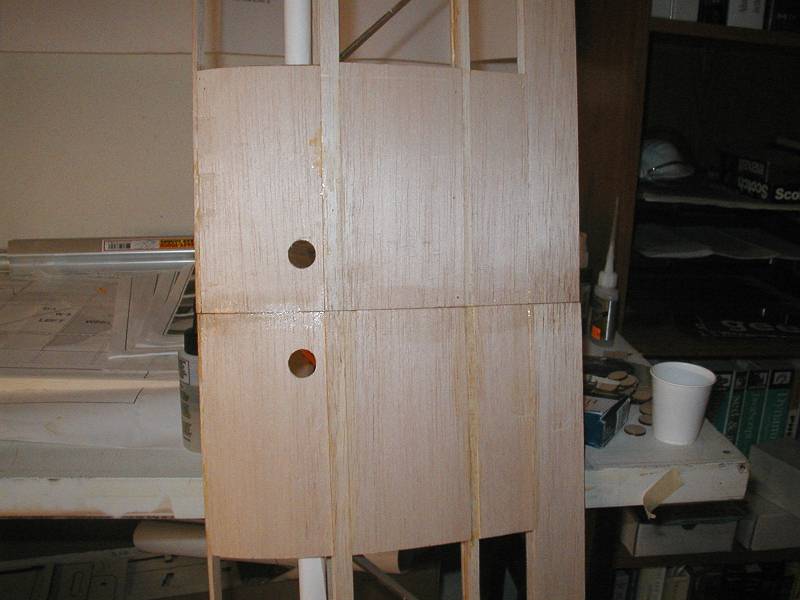

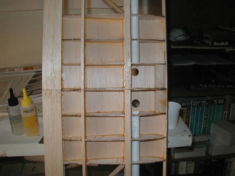

Speaking of the fuse, I want to add a tank compartment hatch. Anyone want to put in there $.02 in on how to do it? I was thinking of changing out fuse top fomer T-1 with lite ply and making two of them. At the front of the hatch I could use the dowl method common on wings, while at the back I can use screws. My biggest concern is how to get the whole curved top to match. I am thinking of building as normal, then cutting the hatch out and adding the dowls/screw mounts and extra formers.
Patrick
EDIT: Forgot the pics.

...Speaking of the fuse, I want to add a tank compartment hatch. Anyone want to put in there $.02 in on how to do it? I was thinking of changing out fuse top fomer T-1 with lite ply and making two of them. At the front of the hatch I could use the dowl method common on wings, while at the back I can use screws. My biggest concern is how to get the whole curved top to match. I am thinking of building as normal, then cutting the hatch out and adding the dowls/screw mounts and extra formers...

Here's a link to another 4*60 build that show a fuel tank hatch on page 4.

RCKen also did a detail for a hatch on MountaineerFan36's 4*60 build.
[link=http://www.rcuniverse.com/forum/m_3070885/mpage_31/key_saga%2Cbegins/tm.htm]Fuel Tank Hatch[/link]
(hope link works heh)
Just another idea...I'd like to do the same on mine.
BTW, anyone ever try to use thin magnets to secure the hatch to the fuse (mounted on hatch and fuse)?
Someone at the club mentioned this to me and he said he never had a problem with the
hatch coming off and it's quick to take off too!

and apply the sheeting. I don't think I quite understand the instructions at this
point as far as trimming/sanding the trailing edge and applying the sheeting over
it.
Can someone (figment??) be so kind as to post a couple pics showing up close side shot and back end of the trailing edge please? I've looked at every pic I could find in other posts and can't quite make out the trailing edge. [&o]
Thanks!
Gosh I hate being a newbie!
it.
Thanks!
#48
Can't post a picture but they want you to use a long sanding block and sand down the existing trailing edge stock so that the rib surface flows smoothly and flatly into it. Right now, as you follow down the rib and get to the trailing edge stock there is an abrupt change of direction. The trailing edge stock needs to be tapered so that when the sheeting lays on it all is flush and smooth.
Kind of hard to put into words. Hopefully someone can get you some pictures or drawings. A good drawing of this would be real nice Ken/Minn if you have one
