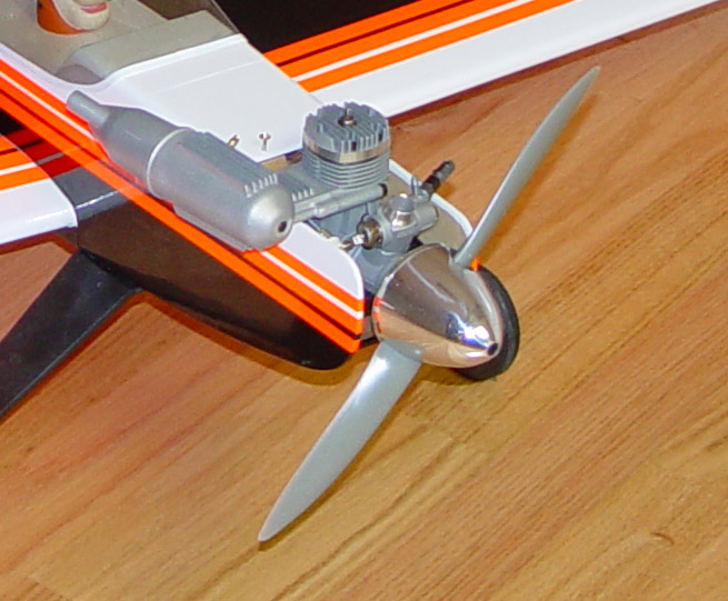

From: Port Washington, WI
Default RE: Help with spinner installation
ORIGINAL: somegeek
I installed an aluminum spinner w/ an APC 11x5 with no problems on my .46 AX. Adapter fit great with no issues.
Ditto on my TT .46

Mine was from Maxx Products, - I think it's just a generic chinese bar-stock import, but it's pre-polished, balances pretty close, and very inexpensive.
