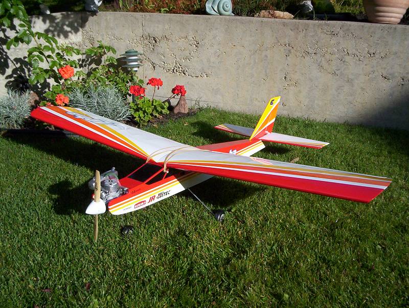

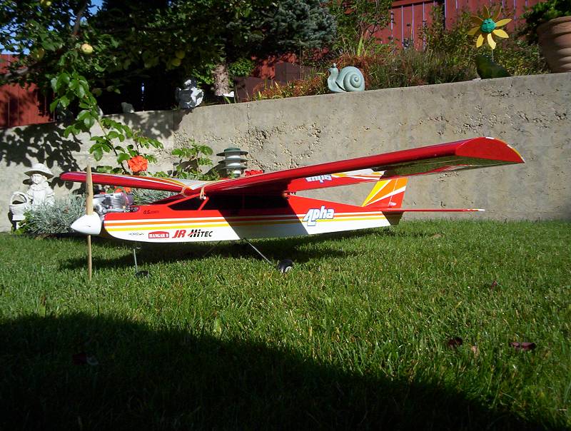

Hey all, just finished buliding up my Hanger 9 Alpha 40 ARF. What a sweet looking plane!
The parts list is as follows:
OS .46AX engine
11x4 prop
4 hitec standard servos
Hitec Electron 6 rx
Optic 6 radio w/synthisized module
and a 5 cell 1050mah rx pack
I cant wait to hear the engine run. I'm going to Break it in today and off to the club tomorrow for some lessons[8D]
P.S. What kind of prop should I use normally? I have a G/F 3 Series Master Airscrew 11x6 prop that the guy at the hobby shop said to put it on after I have broken in my engine. would this be OK or would a 12x4 or a 12x6 be better?
heres some pictures...
