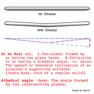

I am a newbie. Can someone define what dimension we are talking about when diehedral is mentioned. Is it the distance from surface to last rib when one wing side is sitting flat on surface or is it when wing is level so that the distance would be half of that.

Maybe MinnFlyer could post up a picture? That'd clear it up quite quickly.
Dihedral keeps a plane level in the roll axis. If it's in a bank, and the controls are neutral the plane will roll back to level. With a sport plane you have less dihedral generally, so that it will stay in the bank with neutral controls. Most trainers have a fair amount of dihedral to make level flight easier to achieve.
The planes with the most dihedral are generally 3-channel designs that use rudder, elevator, and throttle. There's no aileron. The dihedral translates the yaw that the rudder applies into a bank, allowing the airplane to turn. Without dihedral, a rudder-only design won't turn. It also levels the plane when the rudder goes to neutral. If you've got ailerons, you don't need as much dihedral.

hwflyer & MinnFlyer,
Thanks! It was quick and had to keep making it smaller and smaller and smaller, just to get it to upload.
