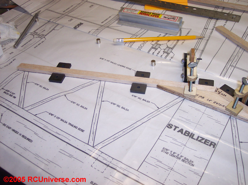

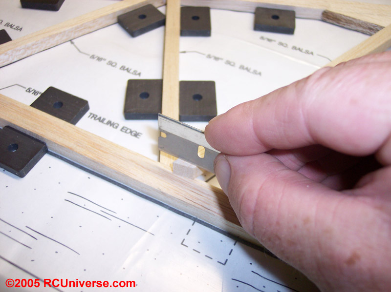

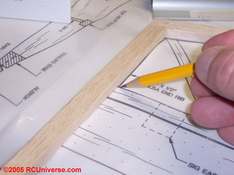

#336
RCU Forum Manager/Admin

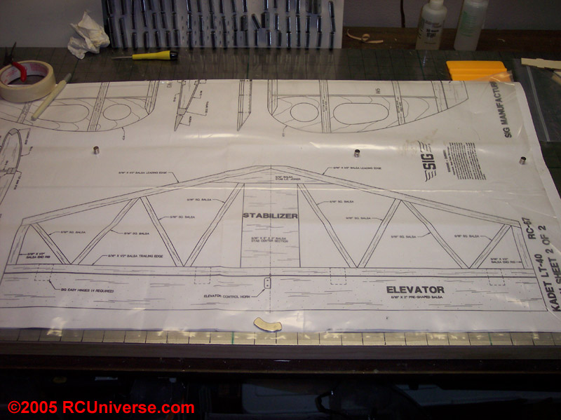

I do need to apologize to all of you out there that are following this thread. I spent last weekend finishing up the christmas shopping that I needed to do, so I didn't have much time to spend here. But the good news is that all of my shopping is finished and I don't have to go out tomorrow. Which is good, because I can't even imagine what kind of madhouse it's going to be at the stores tomorrow!! Anyway, let's get back to the build.
If you are following along with the instructions in the manual the next step is actually to put the pushrod tubes in place, but I'm going to build the horizontal and vertical stabilizers next instead.
I'm going to build the horizontal stabilizer first, but before that I want to talk about a couple of things first. The biggest of which is I want to repeat the statement “Measure twice, cut once.†This becomes even more important here because the biggest part of these next two steps are built from plain sticks of balsa, and cutting the lengths needed will be especially important. Up to this point in this build the majority of parts were pre-cut parts and we just had to sand the edges a little bit, but now we are working with balsa sticks to build these next two assemblies. Cutting the proper lengths of the parts is critical in getting these assemblies built well. It wouldn't hurt to practice measuring and cutting a few times before you start to cut “for realâ€. When you are cutting and building you want the parts to fit with a “wood to wood†joint. Gaps between the parts are very bad. Yes, medium and thick CA advertise that they are “gap fillingâ€. While this may be true and they will fill that gap, the joint will be weakened. For the strongest joint you want a tight wood to wood fit. The next thing to think about when cutting these parts is getting a good straight cut. If you look at picture #2 you can see that I use a miter box for making my cuts. These are invaluable for building kits because they make for very straight cuts. You almost can't go wrong using a miter box. The slots in the miter box ensure that you razor is kept perpendicular when it's cutting the sticks. The last thing that I want to comment on is marking where you make your cuts. This is even more important than making accurate cuts because you can't cut accurately if the part isn't marked properly. I usually use one of two different ways of marking where I will cut. One is to use a pencil to mark the cut, and the other is to use a razor blade to mark my wood. Picture #3 shows using a pencil. Place the wood in the proper position on the plans, and then mark with a pencil where to cut. Make sure you mark both sides of the stick so that you get the correct angle to cut the wood at. Picture #4 shows using a razor blade. Once again, lay the wood in place over the plans, and then use the razor blade to lightly score the wood where the cut will be made. These 2 methods have served my well, but you'll need to use a method that you feel comfortable with. Just make sure that it's giving you accurate cuts.
Ok, let's get on to the building now. For these two assemblies we will be building directly on the plans. Go ahead and place the planes for the horizontal stabilizer on your work surface and cover it to protect the plans. Once the plan is in place we can start building. For the horizontal stabilizer we will use 5/16â€x1/2â€x36†sticks to cut the leading edge, trailing edge, and the 2 sides of the stabilizer. When I am building and assembly like this I like to get the parts cut for the assembly and lay it out before I start using glue to put the parts together. I like to do it this way because I can make any final adjustments on the fit of the parts before they are secured together. Start by cutting the leading edge of the stabilizer. Pin or place the cut leading edge pieces in place on the plans (pictures #5 and #6). After the leading edge is in place put in the leading edge joiner (pictures #7 and #8). With the leading edge joiner in place measure and cut the two sides of the stabilizer (pictures #9, #10, and #11). Picture #12 shows the parts we have cut so far in place. You can also see the center section of the stabilizer sitting in place.
As I said above, I prefer to wait before I start applying glue. So up to this point I haven't glued any parts yet, I am merely laying them in place.
Since I've run out of room for pictures I'm going to here and continue in the the next post.
Pictures
1. Plans for the horizontal stabilizer in place on the building board.

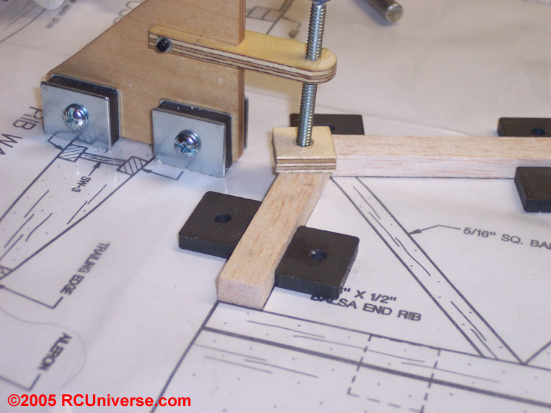

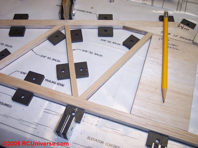

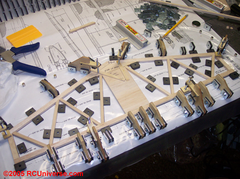

#338

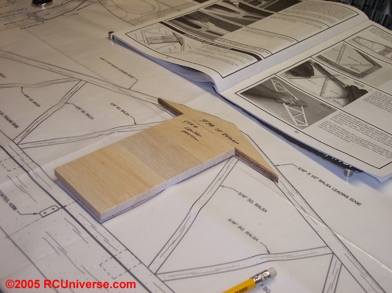

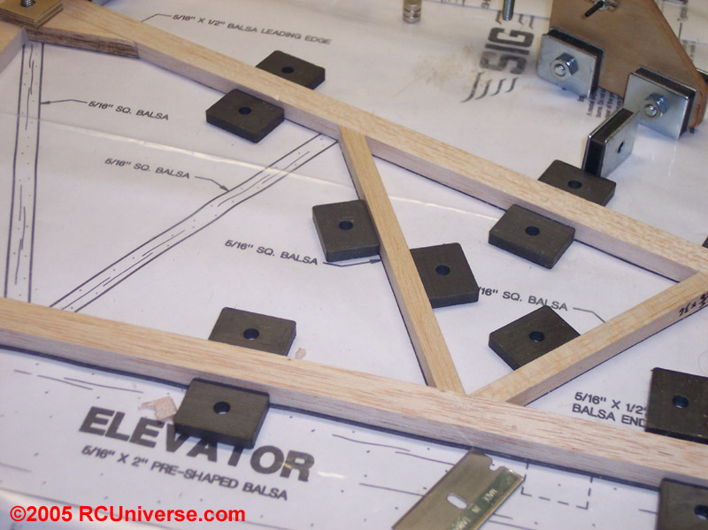

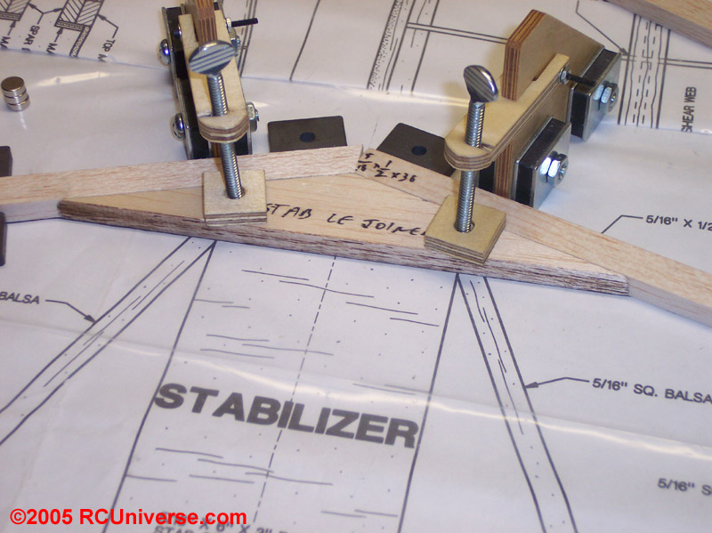

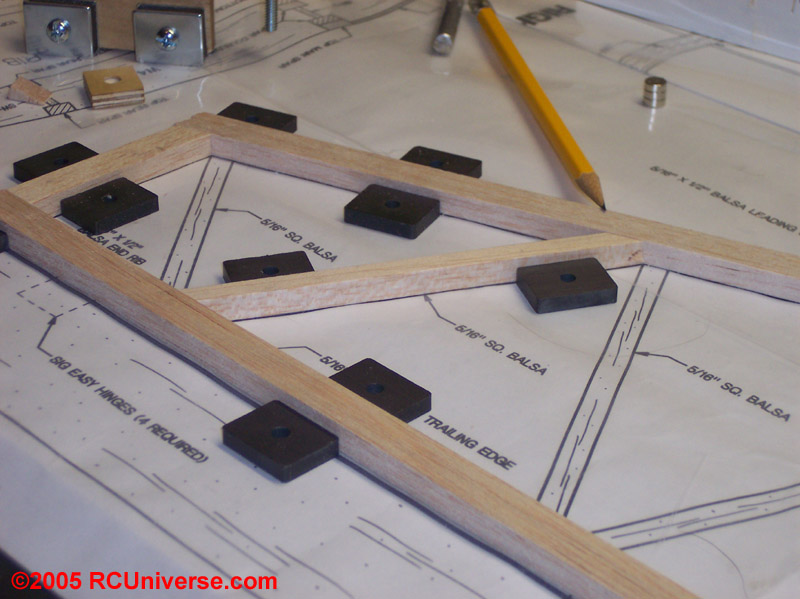

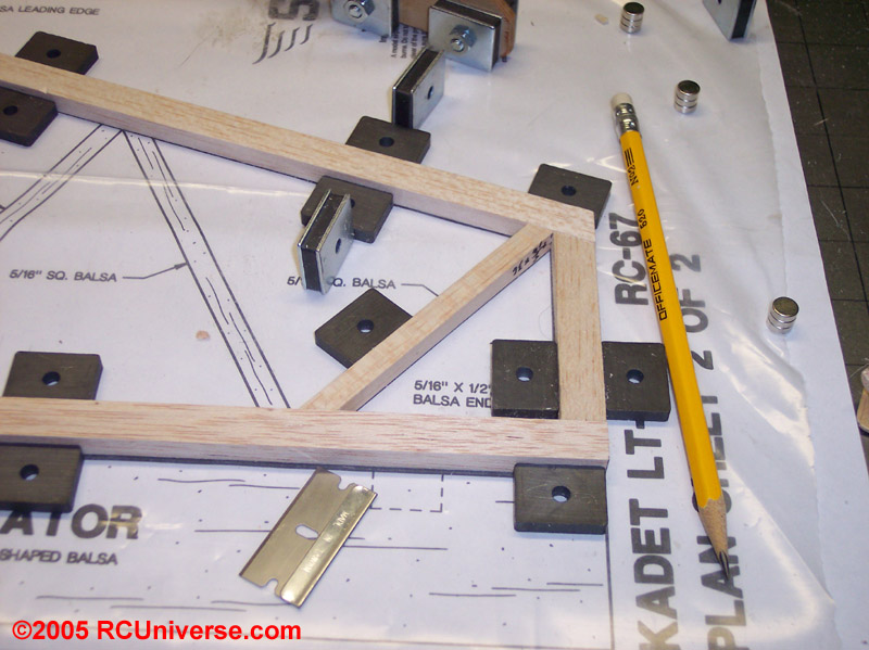

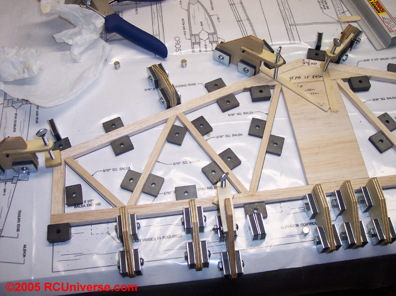

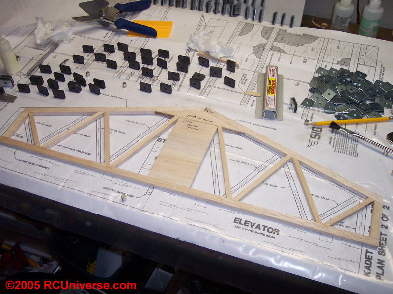

To continue on with the horizontal stabilizer.

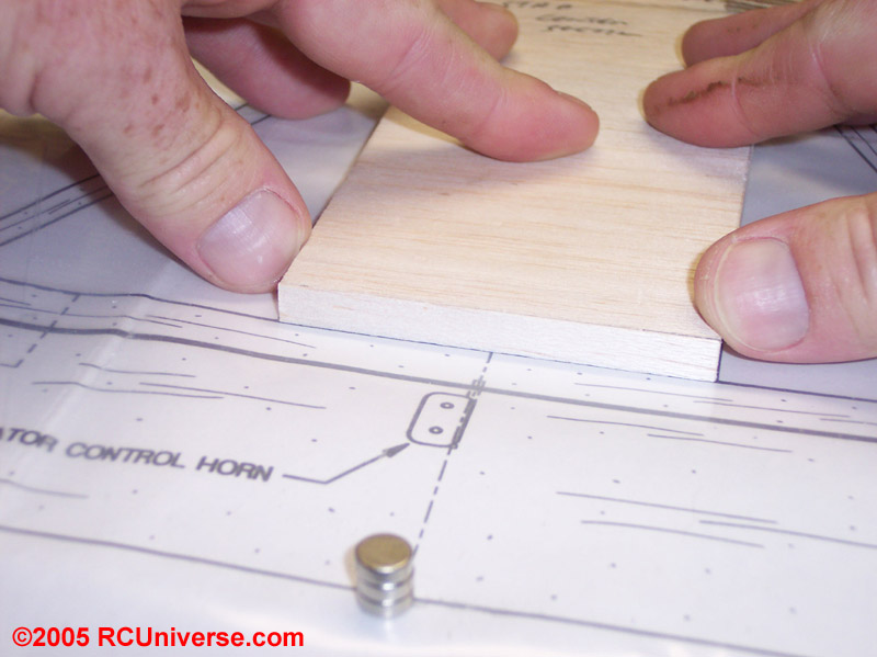

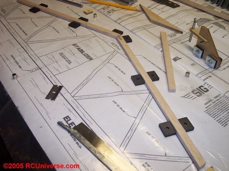

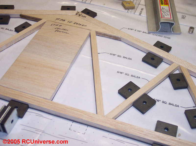

The next part to shape and fit into place is the center section of the stabilizer (picture #1). I wasn't happy with the fit of this piece of wood. If you look at picture #2 you can see that the wood is quite a bit shorter than what the plans indicate. At this point I have 2 choices of how I can proceed with this problem. I can continue to build using the existing size of the center section. This would cause the entire stabilizer section to be a bit shorter than called for. While this will not cause any major problems with the rest of the build, and the finished plane will still fly with no problems, I don't like to build this way. So my second choice is to resize the part so it fits the plans. Since this part was just a bit short there is no need to cut a new part, as this can be fixed fairly easily. To fix this I glued a piece of scrap wood to the end of the center section (picture #3). In picture #4 you can see the part being sanded to the proper length. Once you have the center section sanded to the proper length (picture #5) go ahead and place it into the assembly. Next cut the trailing edge from the 5/16â€x1/2†stock, and put into place on the plans (somehow I forgot to take a picture of this, but you can see the tailing edge in place in following pictures). Now that we have the general shape of the stabilizer laid out, we need to cut and place the cross braces. The cross braces are cut out of 5/16â€x5/16†square balsa. When cutting the cross braces take extra care to get a good tight fit, as these are what gives the stabilizer it's strength. If the joints for these are weak then the entire stabilizer will be weak. I'm not going to go through explaining the measuring and cutting of each brace, but rather will just post some pictures of the progress. You get the general idea of what needs to happen. Pictures #6, #7, and #8 show the left side braces being cut and put in place. Pictures #9, #10, #11, and #12 show the right side being done.

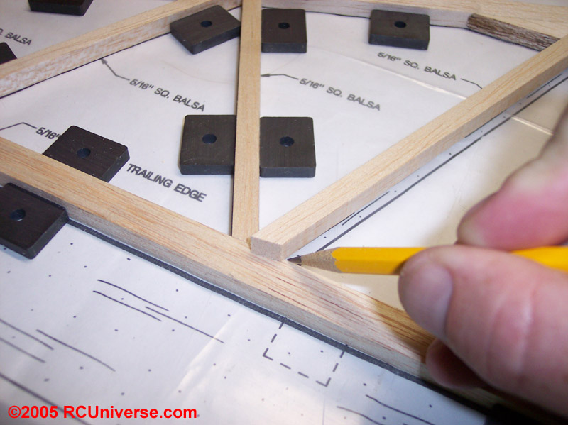

When you are cutting and fitting the cross braces don't worry if you get one cut incorrectly. You will notice that the braces are all different lengths, so if you cut one wrong you can reuse the wood for a shorter piece, and then you can recut the piece you messed up on.
Up to now we still haven't used any glue on the stabilizer assembly. Up to this point we are dry fitting everything. Now is the time to recheck the fit of all joints. So take a few minutes to go back over the whole stabilizer to make sure everything is ready to be glued.
Once again, I'm out of picture space. So I'll stop here and continue in the next post.

1. Placing the stabilizer center section.
2. The stabilizer center section is too short.
3. Adding scrap wood to the center section.
4. Sanding the center section to the proper lenth.
5. Center section is proper length and placed onto the plans.
6. Measuring, cutting, and placing the cross braces on the left side of the stabilizer.
7. Measuring, cutting, and placing the cross braces on the left side of the stabilizer.
8. Measuring, cutting, and placing the cross braces on the left side of the stabilizer.
9. Measuring, cutting, and placing the cross braces on the right side of the stabilizer.
10. Measuring, cutting, and placing the cross braces on the right side of the stabilizer.
11. Measuring, cutting, and placing the cross braces on the right side of the stabilizer.
12. Measuring, cutting, and placing the cross braces on the right side of the stabilizer.
Until next time
Ken
Until next time
Ken
Up to now you should have the horizontal stabilizer laid out on your building board, but there shouldn't be any pieced glued together. If you are using CA you can easily start to glue the assembly together. Wick the thin CA into each joint of the stabilizer. If you are using wood glue like I am you'll need to take the parts out to apply glue to them. But this isn't really a big deal. Just do one part at a time and then replace it back on the building board. It doesn't take all that long to do. I had everything glued up and set in about 5-10 minutes work. I'm not going to go into a lot of detail about this because it's a pretty simple step here. Pictures #1-5 show how I secured the work area while the glue dried. Pictures #6, #7, and #8 show the horizontal stabilizer completed when it was removed from the building board.
The next step will be to build the vertical fin.
Pictures
1. Horizontal stabilizer on the building board.
2. Horizontal stabilizer on the building board.
3.Horizontal stabilizer on the building board.
4.Horizontal stabilizer on the building board.
5. Horizontal stabilizer on the building board.
6. Completed horizontal stabilizer.
7. Completed horizontal stabilizer.
8. Completed horizontal stabilizer.
Until next time
Ken
