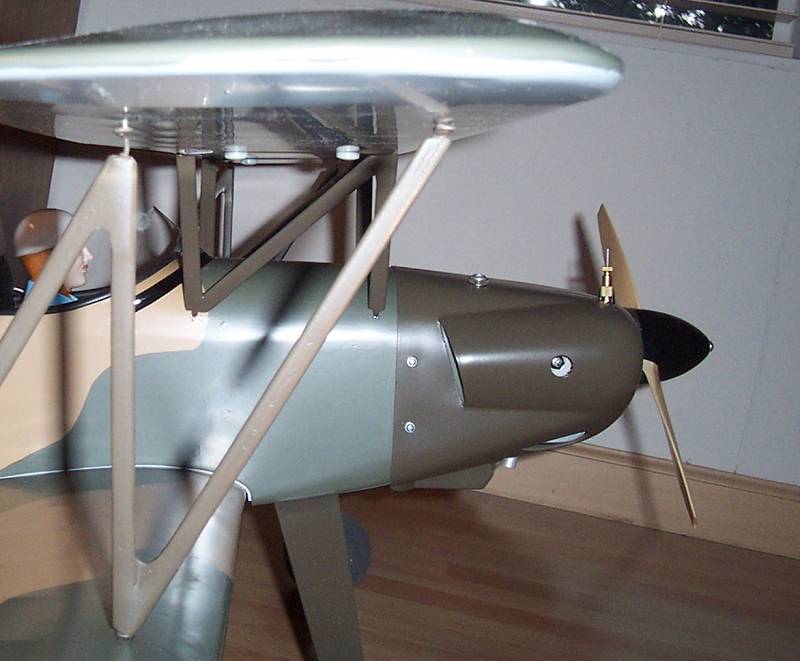

Joined: May 2005
Posts: 499
From: Petaluma, CA
Default RE: how to start the engine?
Or you can cut a hole for the glo-starter. I prime with a finger over the exhaust, usually starts on the first flip (ST .45).
