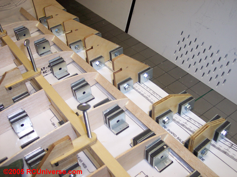

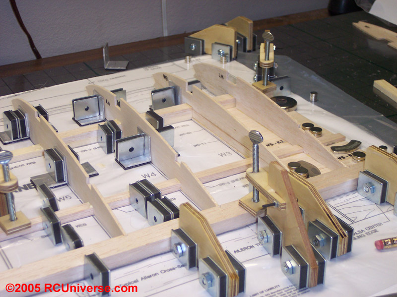

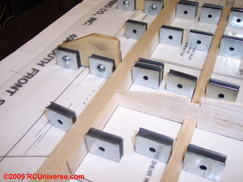

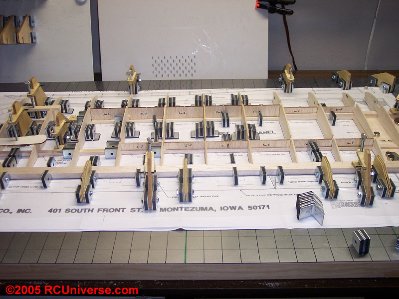

I've got a lot of those little Neodymium magnets that I use. You really need the latch magnets both to make the fixtures and for basic building. The square shape of them let you use them to butt up against parts. And you really need all 4 latch magnets on a fixture in order to hold in place. Trust me on this one. The little Neodymium magnets are great for holding the plans secure on the steel sheet.
Ken

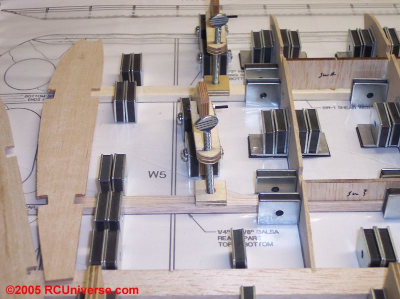

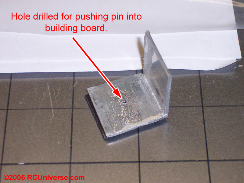

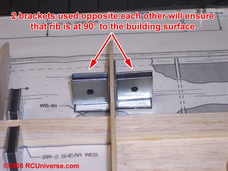

Hey Ken, in the fourth pic you posted above, I see some magnets (being used on the wing ribs) that are sitting on, or attached to what looks small pieces of 90 deg. angled steel. What exactly are those made of, and are the magnets attached, or just being used to secure them?
Old 10-31-2005 | 11:17 PM
  #49
RCKen's Avatar
RCU Forum Manager/Admin
Posts: 28,256
Received 31 Likes on 27 Posts
From: Lawton, OK
Default RE: magnetic building system
Lowlevlflyer,
Those are actually a building aid that I made for when I was still using pins to build with. I took a piece of 1" extruded aluminum that I picked up at Lowe's. I cut them into 1" pieces for this use. For using pins I drilled a hole on one side of the bracket to pin it down with. When I converted to magnets I put some adhesive magnetic strips on the bottom of the bracket but it doesn't have enough "grab" to stay in place. So I use 2 magnets on each bracket to hold them down for this build. Once important thing is that after you cut the 1" pieces it's a good idea to check each bracket with a square to ensure that it's still at 90°. The biggest place I use these is for holding ribs in place while building the wing. Take a look at these pictures and let me know if you have any questions.
Ken

When using the vertical presses, I often use more than a pair of magnets at the front of the fixture. You'd be surprised how easily the magnets will pull from the board when using the presses. I have a "Monster" fixture with 6 magnets (2 pairs of 3) mounted at the front and it still comes off the board before I want it to!
