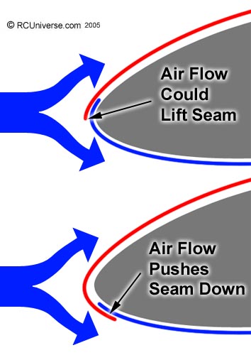

P.S: I am doing a 3-tone color scheme on my plane (i.e: blue front of fuselage, white sides on fuselage, red top of the fuselage and blue on the bottom [see attached photo]) so it would be helpful to see covering pics on how the three colors can be blended without the seams running into each other.

Ok, I have one suggestion regarding your color scheme: You should bring the red on the LE around (IF even only slightly) to the bottom side, so that the seam is facing away from the air stream.
