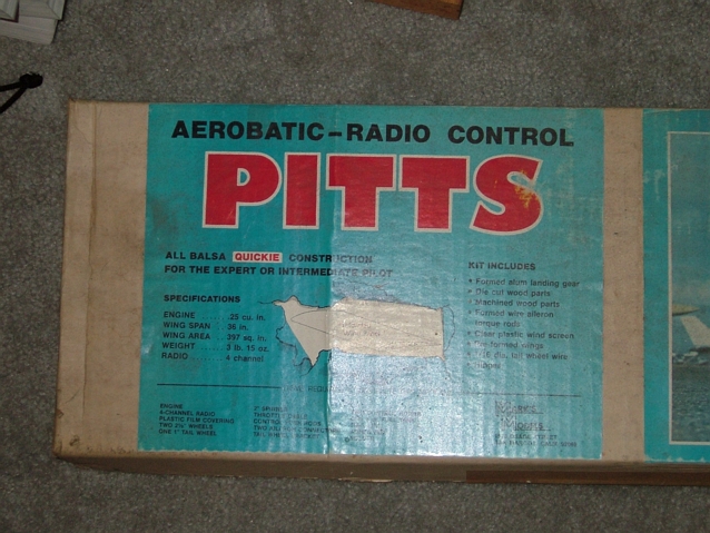

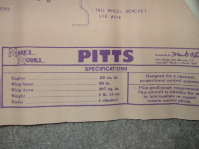

Hey all, I just thought I would post these pics to see if anyone might know anything about this kit. I'm also going to post the pictures in the kit building forum but as I'm still a beginner I thought I would post them here 1st.
I'm thinking of building this plane as my 3rd plane in about an year or so.
Mark's Models was very popular in the 70's and early 80's and the kits built very well. If you are a beginner then please put this one on the shelf as it is a builders kit and even harder to fly due to it being so short coupled and touchy on the controls. Now we can solve this problem really easy by you just sending it to me as I love these bipes!

I just kind of skimmed the instructions the other day and there aren't any pictures and there are alot of terms that I'm not very familiar with, so I'm really considering making my second plane a kit. And possibly building it over the January, February time frame, when ever here in TX it gets a little chilly out. I really like the looks of the Tiger2 plane so I'll probably ask for one of those for Xmas from the wife and see what happens.

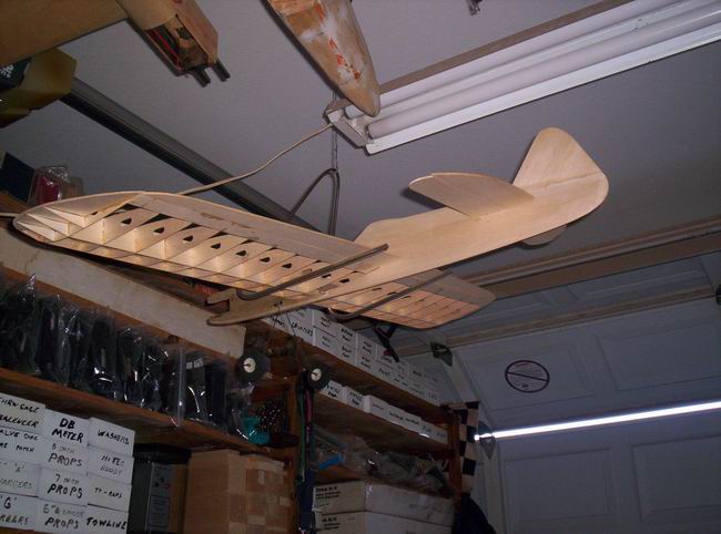

A FEW THOUGHTS ON BUILDING FROM VINTAGE KITS
Building a vintage kit using original lumber can range anywhere from a great joy to a miserable experiance. Almost an art form working with balsa I am reminded of the commercial "it will not be wine before its time". I,ve built many very vintage kits with wonderful lumber but some are not so. Every project must be taken on a case by case basis. Also its important to realize that all kits were not created equal and even when new some were supplied wood not even very usable. Taking into account approriateness of density and grain for its intended purpose.
Before I get roasted by the vintage purist, let me say many suggest that you never build a vintage kit but save it, Its too valuble. I do not think like that, while I do have a substancial stash of tresured kits, most were originally purchased by me for me. I do usually have a copy of the plans made to work from and make templets of any diecuts but do enjoy working the vintage lumber. I,ve no interest in feeding the 'EBay Opportunists' with my leftovers when I,am gone.
So brocj do enjoy your kit and build it but do not even thank about flying it for some time (only you will truly know when that time is right and its not related to some number of airplanes, first second etc.) Also keep in mine vintage kits generally are far more demanding than modern kits in many ways therefore its best to begin with a modern beginers type kit. You will find its the differance between night and day.

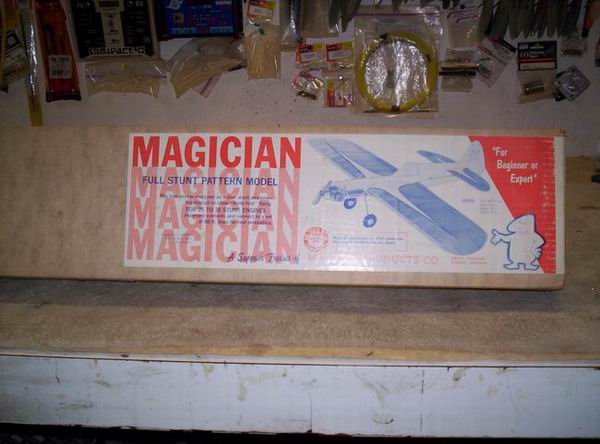

This first picture is a kit I first acquired in the mid fifties and built just five years ago (a challanging build because this company used non scale small plans and relied on diecut notching for alignment. The lumber on this one was awfull and about 50% had to be replaced. Flew it for a year untill my wife took it away from me and made me hang it up, the 'Its so cute syndrome" She passed away a short time later so out of respect it will hang there untill I,am gone.
The next two pictures are of a one underway. Its lumber was perfect and an excellent density and grain for the intended parts.
The last photo is a 1961 kit that will be next. Its the 1960 1/2 A free flight nationals winner and agine the lumber is perfect.
Enjoy John

I came into this late, because I've been out of town. Seeing that kit is a blast from the past! When I briefly fooled around in RC in the early '80s, before I got back into RC two years ago, I had a friend who built a Mark's Models "funscale" Pitts. I've tried to find reference to it on the internet without success.
I would disagree that it is a particularly challenging kit to build. As I recall, the wings are solid balsa, with an undercamber to them, which becomes a flat-bottom airfoil when covering is applied. It was designed to be pretty simple to build. I don't recall that it was necessarily that great to fly. It is a small plane and may be a bit on the heavy side with the solid wing. I agree that it's not a second or even third plane for flying, but you could probably build it with a little help.
-Scott
Edit -- I looked a little closer at the label on the box and confirmed that it does have the solid balsa wings I described.
