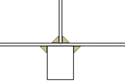

I am building my first plane its a Sig LT 40. I have seen numerous comments from other fliers on this forum state that they had to put triangle re-enforcements along the bottom of the stab. I have'nt got that far on mine yet but your story convinces me its the way to go...sorry to hear about your plane.

Default LT 40 stab
I now have the LT back together with the smaller engine but do not really have a cure for the stab falling off and had not heard others with a similar problem. I am reinforcing the front of the stab since it drops slightly into the fus at that point. Other suggestions welcomed. This is my first kit and I spent so much time on it that I fell in love with it. wrong thing to do with a trainer. I just finished the Armidillo, coroplast and all, and it took no time at all and I am more than ready to risk it in the learning process and I suspect it is a whole lot more durable when its flight path intersects mother earth.

Bob, just cut some balsa triangle stock and place it under the stab where it meets the fuse and on eash side of the vertical fin where it meets the stab
