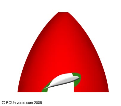

Sending out an order to Tower Hobbies today and I need to know. I received this post in my thread . . .
Trimming the the spinner is almost mandatory if you are using APC props. MASTER AIRSCREW props tend to fit without a problem along with wood props . So if trimming is out of the question then change the brand of prop you are using. Top flight make wood props. Other than that a .46 engine will be begging for a prop that has a pitch of 6 or better. GL.
. . . and was wondering if the propellor material is all that important for either beginner fliers or trainer airplanes. Master Airscrew appears to only make wooden propellors so are they OK for trainers and beginner pilots, or should beginners and/or trainers stick to nylon props? If I'd be better off with nylon, what is a good brand that fits good into plastic spinners without having to trim or too much fuss?
Thank you for any speedy answers I can get.

Master Airscrew makes both wood and composite props. Whether or not any prop will interfere with the spinner is a question only trying it on will answer. Thatever brand or material of prop you decide on, make SURE the spinner cone does NOT touch the prop blade. In fact, why not use a safety nut, like made by Great Planes and Dubro?

Use the spinner--for two reasons--aerodynamics around the prop, and safety. I've had engines throw props before, and the spinner was the only thing that kept the prop from flying off and hurting someone. Unbelievably, it didn't even break the spinner. Had it broken the spinner, though, it would have still been money well spent!
Enlarging spinners isn't a very big deal at all. In fact, for most props on .46 sized motors, you won't have to enlarge the spinner holes at all--especially if you stay with a conventional 10 or 11 inch prop, and get a 2 1/2 inch or 2 3/4 inch spinner.

[link]http://www2.towerhobbies.com/cgi-bin/WTI0091P?&C=QBC&V=MAS[/link]
Here is a link to about 105 different "Glass Filled/Composite" propellers listed on Tower's website. I try to tell beginners to stay as far away from wood props at they can. The problem with wood props is as soon as you touch it to the runway it will shatter, no if's, and's, or but's. And I have never seen a new pilot that didn't touch the runway with a prop. It's going to happen. I have found that the Master Airscrew Glass filled props really are the most forgiving propellers for beginners. They can take quite a beating and still work well on the plane. And since you are learning you are going to be rough on a prop, as well as the rest of the plane. It just goes with the territory of learning. It happens. Get your props from the link I posted above and you will be fine.
As I said in your LT-40 thread, use the blue spinner you want to on your plane and trim it to fit the props. It really only takes a few minutes with an X-acto knife to trim the spinner to fit the prop. I know that this may scare you, but it's part of the hobby. It's really no big deal to trim spinners. Like I said before, just trim it back so the spinner doesn't touch the blade of the prop. Look at the attached diagram to get an idea of what I mean.
