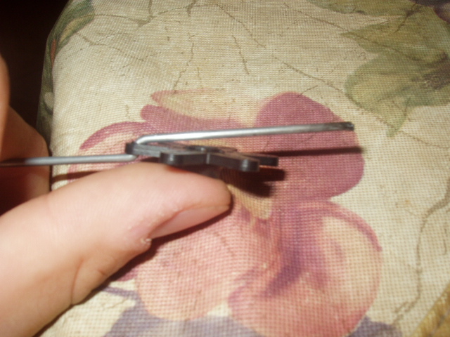

Sorry, yes it is a Deboniar. Heres a couple things I've noticed. The inside of the aileron moved more than the outside, I think because the control horn is on the inside. Being a plastic coroplast aileron could it be flexing? Does that matter? The second thing is that it seems like the push rod is stiff. Do to the fact that the top of the wing is curved, the rod had to flex to meet the control horn. Its not much but it is there. Not sure on the rod diameter, but I had to drill out the servo arm holes to get it to fit. I'll post a picture when I get home. The wing is in fact a flat bottom. Thanks!
Yes it could, and that's not good. Most of your roll control is on the outside half of the wing. You might want to replace them with hard balsa. Before you do that, however, check your hinges and make sure they all move freely.
That's a straight-run pushrod that's completely outside the wing. It should move freely. Angle the horns so they match the angle of the pushrod.

I think the stiffness is coming from my Z bends. It seems like the middle of the "Z", where the control arm sits isn't tall enough for the arm. I'm using Z bend pliers (hobbico), not sure what to do where. Maybe the push rods are too thick? Again, I have to enlarge the hole to get them to fit. Thats more the stiffness I was talking about. It never actually touches the wing. I'll post some pictures of all ths later.

If you're using 4-40 rods, the Z bender you mention (same one I use) will make a Z bend that's too short for the servo arm thickenss. You can still use this tool, however. Make the bend and insert the rod in the servo arm. Look at the angle the rod sits in the servo arm with the other end free. Bend the rod so it's level with the arm, about 1" from the end. I've done that a lot, and it works well.

So go ahead and make the Z bend like normal? Heres a picture of how that looks. Notice the angle? So to fix this I bend the servo arm end or the clevis end? Why would Hobbico make it like this???
Is this whats responsible for my aileron problem? I've been sort of forcing it together like this. [:@]

yes it probobly is you should cut that off so it sticks thriough the servo arm just a little bit hope this helps

Oh yeah, I'm not using it like this, I just extended it to show the angle better. My point was that the Z bend was too short which wasn't allowing the push rod to lay flat.

Make the bend about 1" away from the Z bend so the rod is parallel with the servo arm. Hobbico designed this bender for 2-56 rods. It's sturdy enough for 4-40, so it's used there a lot. Hobbico should make a bender for 4-40 rods. If you force the rod down to the horn, you'll twist the servo arm, causing the binding. The bend in the rod eliminates that problem.
