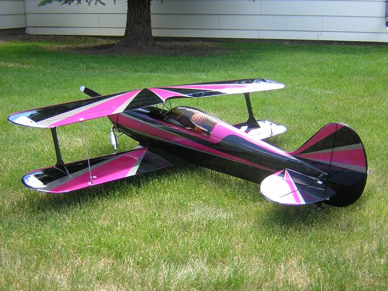

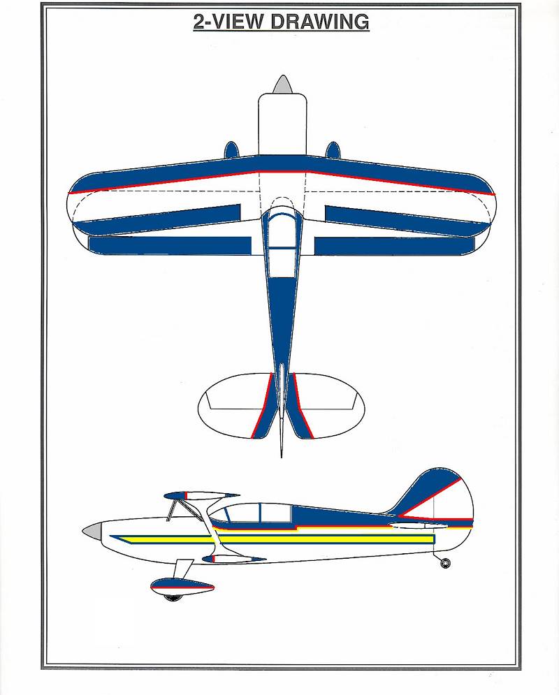

Below is a sketch of the color scheme and a photo of the box as I received it. I'm still not sure how to cover the bottom yet, but there's plenty of time to figure that out.

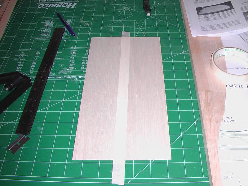

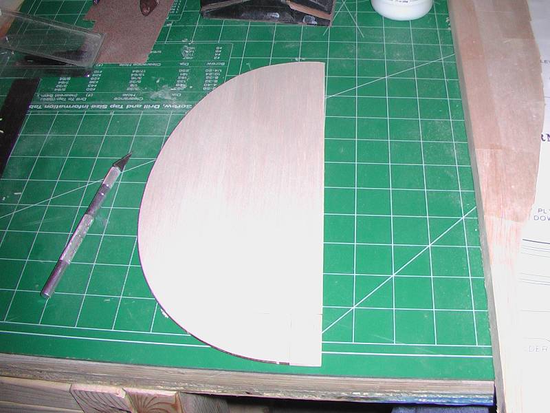

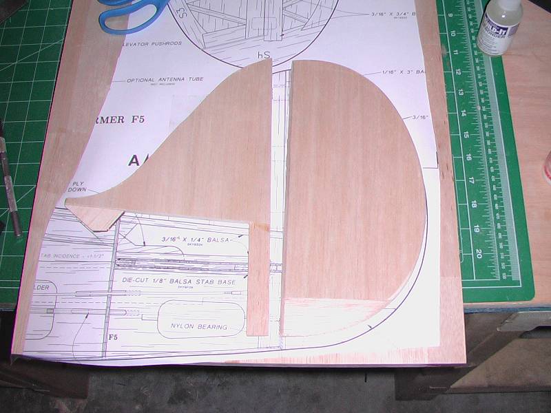

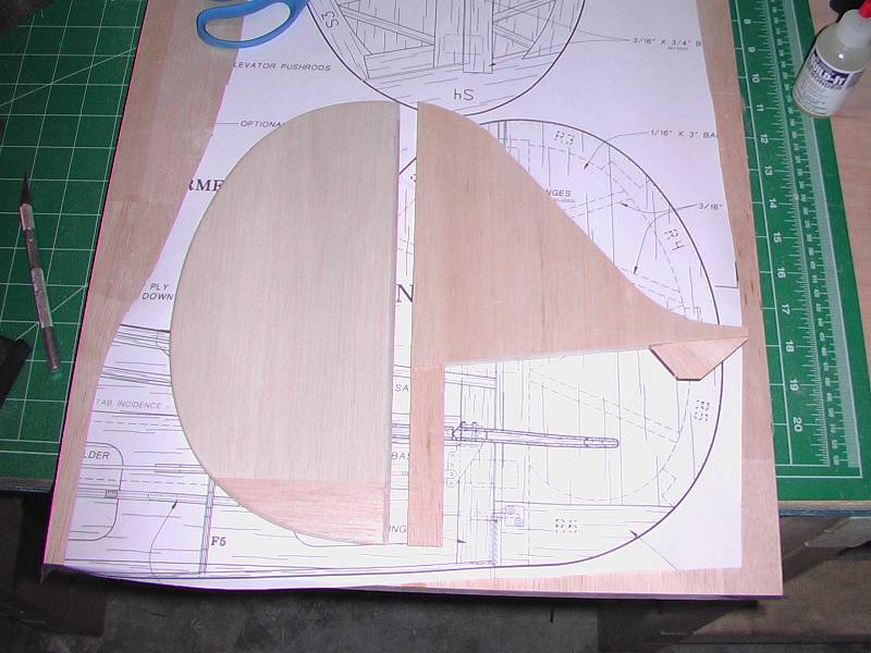

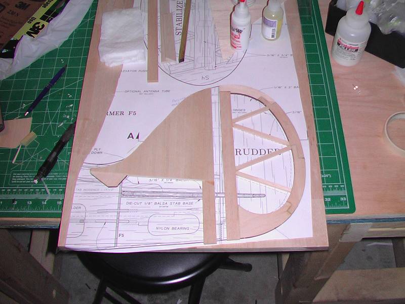

Build is actually coming along nicely. The manual is very clear and easy to understand. I especially like the fact that the surfaces are sheeted. Helps the film follow the shape of the contours. Here's a summary of the progress so far:
1. Ran a straight edge w. razor blade on both halves of sheeting to be joined
2. Used masking tape to tack both halves together snug.
3. Flipped the sheeting over and ran a bead of medium CA in the gap.
4. Layed both sheet out flat and used a paper towel with acetone to wipe away the glue that ran out of the joint.
5. Attached sheeting to the rudder
6, 7, 8. A little sanding and carving later, I have a rudder and fin.
I'm still a newbie at building. If anyone has a better way of doing this or new ideas please reply (with pictures if possible).
