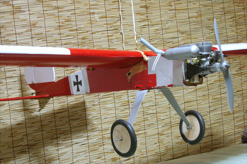

BTW, here's the "WWI trainer" I'll be using it in. For the moment I've installed my "best" Rx so I can keep flying. I probably won't get my Flair Legionaire done before the break anyway.
