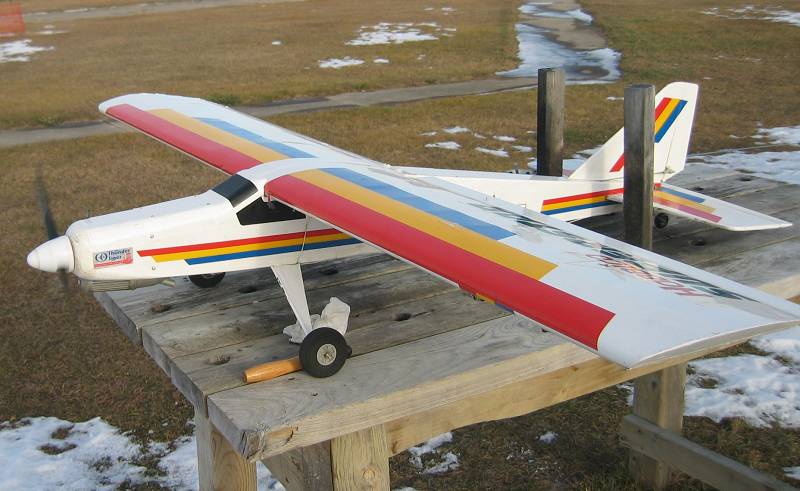

The Sig Kougar is the best "wind-handling" sport plane I've ever flown. It is an old-fashioned kit and a bit involved to build, but the end result is well worth it.
I realize that kits are out of favor now with most folks. But this one is a classic that flies "big" for a small airplane. Of the many ARFs I've had, only the larger scale aerobats, designed for precision flying, fly as well. None of the 40-size "sport" ARFs can come close to the Kougar; IMO, anyway. YMMV.

I'm going to agree with Steve here and recommend the Sig Kougar for
windy conditions. My old Kougar is my windy weather plane and Ive
flown it under conditions that keep most everybody else at home.
Anything under 20 mph is like no wind at all. Ive even made crosswind
landings in 20 mph winds with it.
It may not be an ARF (and thats a good thing) but its one of the
best flying 40 size sport planes out there. Get one while they are
still available.
Mike Hammer
