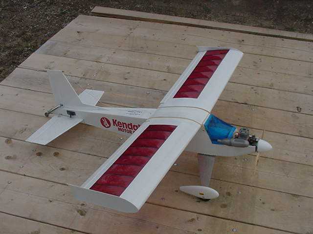

Okay here is the update...
The twist is pretty much hard to tell now after sheeting top and bottom (measured the stablizer to the table - 1 to 2 mm difference at the most).
SST, yes, you're right this would be my first trainer and yes, I need to seek services of a instructor (ANYONE LOCAL??) for this preflight inspection and eventual training. Yes, the airfoil is semi-symetric rather than true flat bottom. I suppose that is why it is called "super sport" trainer. It is would be ideally suited as 2nd trainer perhaps. I was told that it is little harder to fly but not impossible (with instructor of course).
Mode 1, I believe this kit was made/sold through Hobby Shack years ago and no longer made. I understand that Hobby People now replaces Hobby Shack. I could post photo of carton to show you if you like.
My plane is most similar to your "kendall" plane (white with red transparent) without the wingtip and mine is tricycle landing gear out of 5/32 mains and 5/32 nose. I think I might as well forgo that 5/32 main gear for aluminum version on account that it is easy to bend after not-too-soft landing. I assume that you perhaps converted yours to a tail dragger and added the wingtip to the wings. Otherwise, it looks identical to mine under progress.

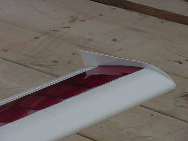

By the way, I forgot to ask SST about his wing tip. I am wondering what is the function of adding a "wingtip" to the wings? Will it make it much more "controllable" or something? Is it something I should consider doing it to my plane now? I did few modifications to the frame, mostly additional bracing to the rear section after seeing how "thin" the balsa sheeting and didnt want to take chances of it coming apart. But I didnt want to "overbuild" it too much on account of weight.

Tip plates improve stall and low speed handling characteristics. Ailerons remain more effective at landing speeds. I use them now on most of my planes unless they're scale models.

Thanks, SST! Now, another question... how do you know what size of wing tip to be effective? Is there a mathematical formula or just plain eye-balling it? I might do it the same.

Nope. just eyeballed it, and tried to make it look decent. The leading edge is flush, as the important part starts behind the spar as the wing thins out. It's probably .75"-1" above and .500 below the wing at the TE.
