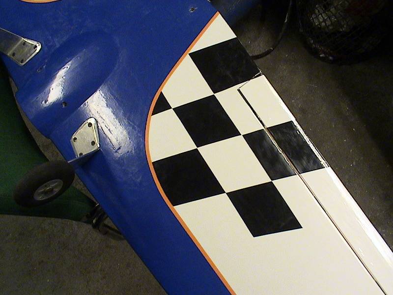

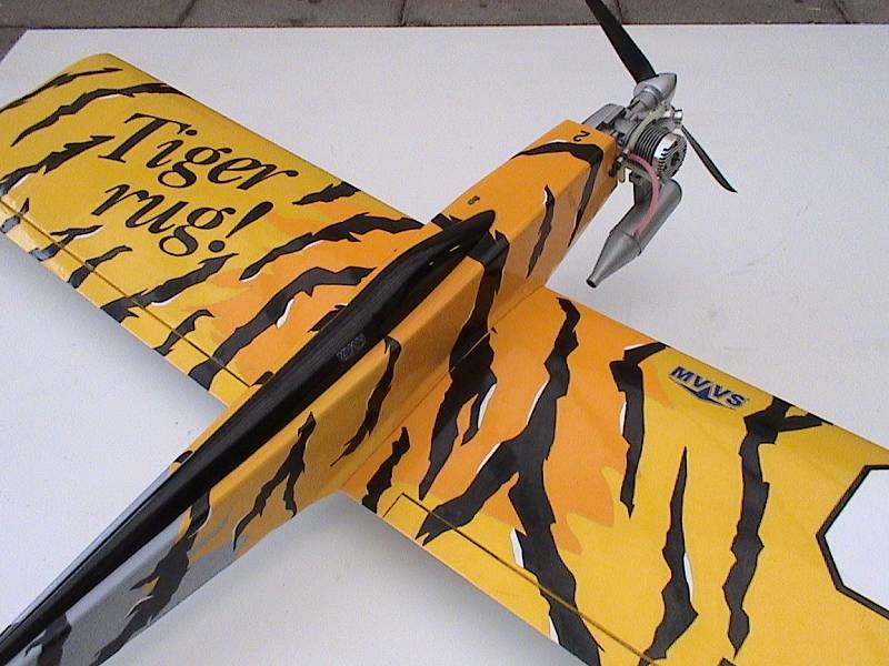

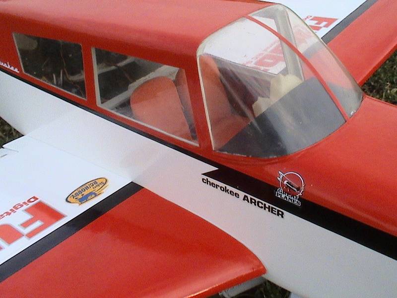

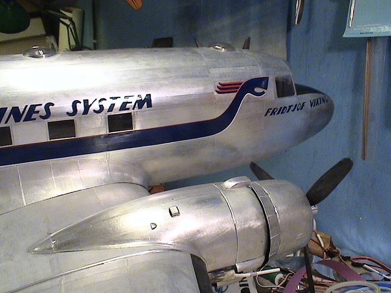

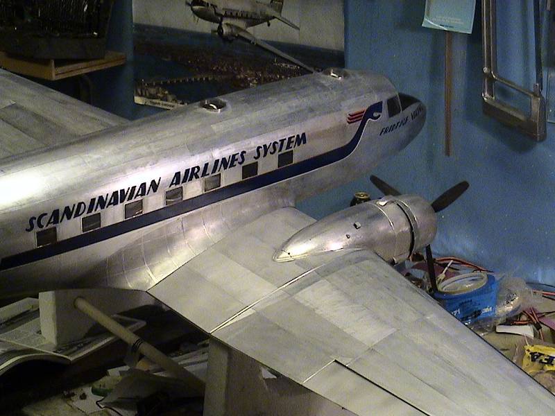

ID:	369577   Click image for larger version
ID:	369578   Click image for larger version
ID:	369579   Click image for larger version
ID:	369580   Click image for larger version
ID:	369581   Click image for larger version
ID:	369582   Click image for larger version
ID:	369583   Click image for larger version
ID:	369585   Click image for larger version

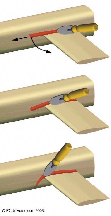

I am going crazy trying to cover my supersportster 1.20 size!!! I've been trying to cover the section between the vertical and horizontal stab. It is definately getting the best of me. I'm using ultracote, ANY tips????

MinnFlyer
MinnFlyer's Avatar
Join Date: Apr 2002
Location: Willmar, MN
Posts: 28,519
Received 8 Likes on 8 Posts
Default RE: best covering for a newbie
Flyboyz, cover the corner with a 3/8" wide strip (or narrower) first.
