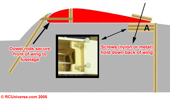

I reading the instruction manual over and over again to my Thunder Tiger Easy Trainer (before I start assembly) .... and something just seems to be "not right" in the manual (apart from the fact that some of the details are rather sketchy). I can't figure out how the wings attach to the body of the aircraft. I know usually there are two nylon screws that hold it on ... but I can't see anything like this in the parts list and I just can't see them in any picture of the trainer.
Any ideas? Hints? Or suggestions? Please ...

I haven't seen that particular plane close up, but it's quite common for trainers to use rubber bands to hold the wing on. For beginners, these are a much better choice as they allow the wing to move in the event of a crash. Did the plane come with a couple hardwood dowels, and are there holes in the fuselage near the leading and trailing edges of the wing saddle?

I don't recall seeing any holes in the wing saddle ... I'll check tonight because I'm at work right now. But there definately are no hardwood dowels in the kit! However I don't see any rubber bands in any of the pics of the plane ....

I did a quick google search on that trainer and I came up with a few pictures of this trainer, unfortunately it was difficult to tell from the pictures exactly how the wing is attached. But, in you post you mentioned that there are nylon screws to attach the rear of the wing to the fuselage, so I'm going to use that as a reference. Normally, in wings that have screws to attach the rear of the wing the front of the wing is attached directly to the airframe in some manner. In most cases there is a dowel rod extending from the front of the wing, in the center point of the wing, that is inserted in a hole in the former located at the front of the wing saddle on the fuselage. Sometimes it is two dowels instead of one, but that is usually how it works. You insert the dowel of the wing into the hole in the former and then push the wing as far forward as it will go, then you use the nylon screws to bolt down the wing into position. This will hold the wing in place while you fly.

Thanks for the reply RCKen ... but I was saying that I am familiar with nylon screws holding down the wing - but in this case the wing doesn't seem to be held in place by anything! And the manual doesn't seem to go into this "minor" detail!

Ok ... that sounds about right ... because in one of the pics in the manual you can make out two screws coming out of the wing. But nowhere does it ever mention putting them in!

Ok, I've put together a diagram to hopefully show what you need to be looking for. The drawing is over simplified, but you should get the idea. Look for a hole in the former (cross member between the two fuselage sides) and there should be a hole (can be either square or round) that will serve as a hold down for the front of the wing. If the instructions are so weak on details then there may be a dowel hole already drilled into the wing for a dowel to be inserted.
If this still doesn't help is there any chance you can upload some pictures of the fuselage, wing components, scan of the the instructions??

Wow! I'm impressed (now I feel bad about asking so many questions). I'll take a look at the model tonight and I'll get back to you. I'm sure I can get a few pics up if need be
However I don't see any holes in the wing per se (but this doesn't mean that there aren't any holes under the covering as almost all holes are buried under covering).
According to the additional equipment list, #64 rubber bands are needed. The #64 rubber bands are typically used for holding the wing on.
If you want to use the rubber bands, look for 2 dowels several inches long OR there may be 4 short dowels (about 1" - 2" long ) that will probably have a plastic type cover over it. The cover may or may not have a screw in the end securing the cover to the dowel.
If you want to use nylon bolts to secure the wing, it is not difficult to convert the wing to a bolt on type. Just starting out, I suggest going with the rubber band mount.

If this is the model I think it is, I just soloed on it a few weeks ago. It uses rubber bands to attach the wing, I built it in 1994, but seem to recall having some difficulty with the instructions.

Ok, so I found out that this is a rubber band mounted wing. However in the parts list (and the parts) there is only 1 dowel!

On mine, there are two wooden dowels. One on either end of the wing saddle on the fuse. As I recall, the holes for the dowels were not pre-drilled.
Is it possible that the wooden dowel is twice as long as is needed? Is it long enough to be cut in half and still stick out both sides of the fuse at least 1/2"?

OK, I think I found the correct manual.
http://www.acehobby.com/ace/PDF/Airp...asyTrainer.pdf
On page 5 it shows a picture of the parts which includes 2 dowels. I didn't find, in my qick read thru where it says to install them. There is only one picture of one installed on pg 15 and that is poor. I may have missed something though as I was in a hurry.
I hope this is the correct manual. I imagine you will need to cut the covering ( locate holes from inside) to install dowels. You may need to go to the LHS for another dowel if you have lost one or never got it. Easier than waiting for replacement unless local dealer will replace it.

"There are 1/4" holes in both fuselage sides in front of and behind the wing opening for the wing hold-down dowels. Cut the covering away from these holes and install the two wing holddown dowels in these holes."
Sounds like the mystery is solved, but unfortunately, he'll need another dowel.

Thanks everyone! I got myself another dowel .... no problem when your dad happens to be a woodworker! (Hey dad ... I need a 1/4" dowel. Got any? Yep - over there) I completely missed that paragraph trolling through the instructions ... thanks again.
Now all you need is the #64 rubber bands. We can buy those cheaper here at office supply stores. Use 10-12 of these and criss-cross at least the last pair so they don't tend to slip off the dowels as easily. The rest can/should go on any other way you like (straight front-to-back). If you lose less rubber bands the wing may lift from the fuselage during high G manuevers. This will change the incidence angle of the wing (among other things) and can be VERY bad. [:@]
