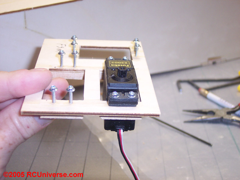

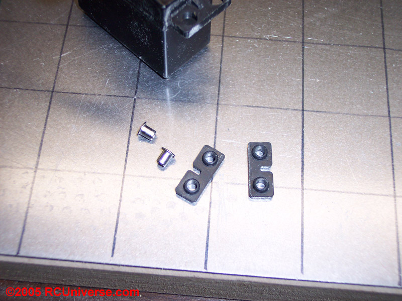

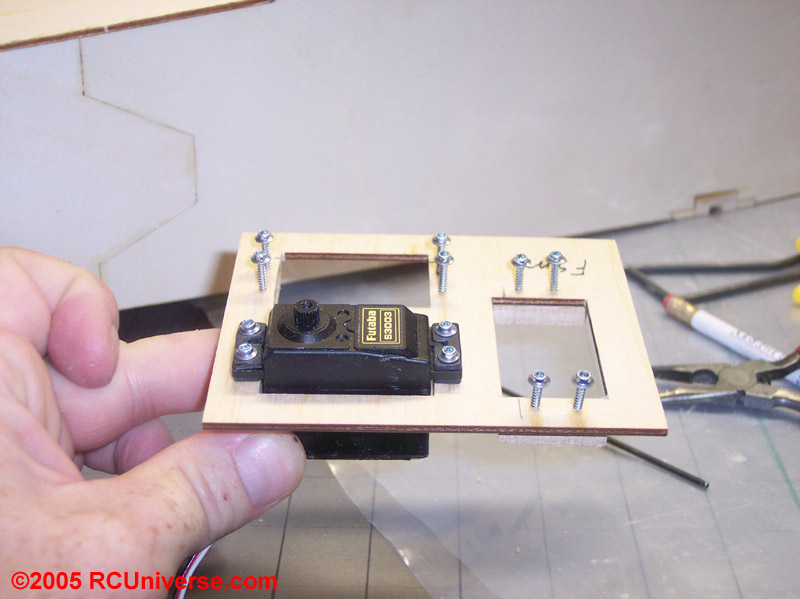

RE: Servo installation info requested
netdudeuk,
Ok, let's see if we can get you squared away here. For each side of the servo you are going to need 2 of the rubber mounting strips and 2 of the metal grommets. Look at picture #1 and you'll see what I am talking about. You put on if the rubber strips on the top and the bottom of the servo mounting lug. Notice in the rubber mounting strips there is a small split in it, this will line up with a tab on the top of the servo mounting lug. Picture #2 and #3 show how to place the rubber mounting strips. Once you have them in place you will insert one metal grommet into each hole from the bottom of the servo mounting lugs. It's very important that these go in the bottom. In picture #3 you can see the metal grommets in place. Picture #4 show them all in place on the servo mounting lug.
Once you have this all together on both ends of the servo. There is one more point that is very important. When you mount the servo you will place the servo in the mount and then put a screw in each mounting hole to secure the servo in place. When you tighten down the screw you want to STOP when the screw head JUST TOUCHES the rubber. See the last diagram to see how it all should sit. This is very important to do because this setup provides isolation from vibration for the servo. If you tighten the screw too much the servo will no longer be isolated from vibration, and vibration can kill a servo in a heartbeat. So it's very important to no over-tighten the mounting screw.
Please feel free to ask any other questions you may have about this. I hope I was able to clear it up for you.
Ken
Thanks for the prompt and comprehensive answer. It all seems clear but there is one question. Please will you confirm that the metal inserts have the 'flat bit' at the bottom and not at the top ?
Netdudeuk,
Yes, the metal grommets go in the bottom part of the servo mounting lug. Look at the last diagram that I included. The flat part of the metal grommets must sit between the bottom of the servo mounting lug/rubber mounting strip and the surface that you are mouting the servo to.
Oh, hang on ! I've just detected some shoddy workmanship !!
While I mentioned the S3003, Ken could only be bothered to get out a S3004
That could have had me well confused LOL

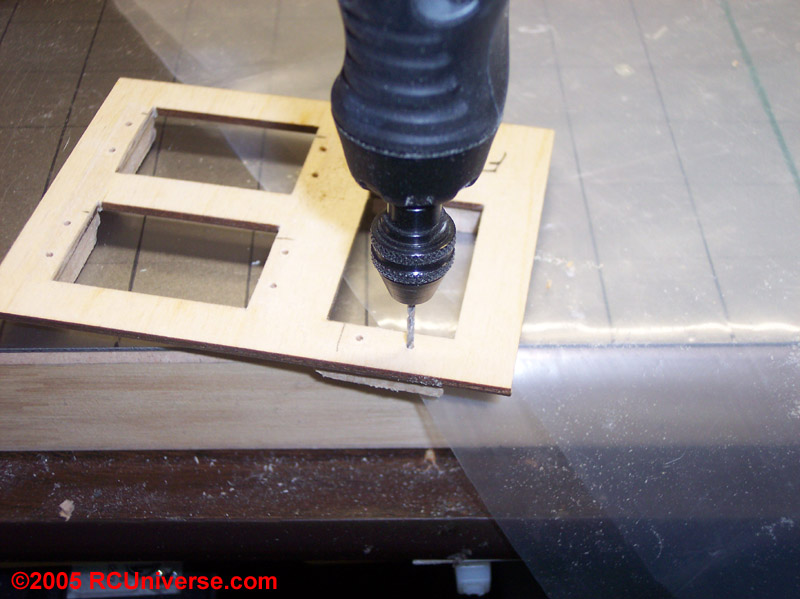

RCU Forum Manager/Admin
DrFrier,
I'm the opposite of Minnflyer in the fact that I do predrill the hole. It's really almost a personal preference and you can do it either way that you like. Once I predrill the hole I will run the screw down the hole, back it out, and use a little thin CA ot harden the threads in the hole.
What Minnflyer said is about how far to tighten the screw down is pretty much right on the money. I usually watch the rubber and if you can see it distorting or "puckering" then you have tightened it too much. Take a look at the attached pictures and hopefully you an get a good idea of what is too much. In the first three picture there two mounting screws for the servo, the screw on the right is properly tightened down and the screw on the left is over-tightened. Now I will point out that the screw on left is a bit over done for "dramatic" effect and this is because I had to "over do it' to make the point.
I've included other pictures just to show how I do pre-drill and use CA on a mounting hole. Also included is a shot of the hardware I use to mount my servos with. I've found that these socket head screws are the neatest thing since sliced bread for mounting servos with. You can get that at [link=http://www.microfasteners.com]Micro Fasteneres[/link] or [link=http://www.rtlfasteners.com]RTL Fasteneres[/link] . IMHO they are well worth the little bit of extra time you take to order them. One of the best thing I like about them is that you don't strip them out like regular screws do. Give 'em a try and I think you'll really like them. I usually buy the assortment boxes that have a good range of hardware that I use for my planes.
I hope this helps
Ken

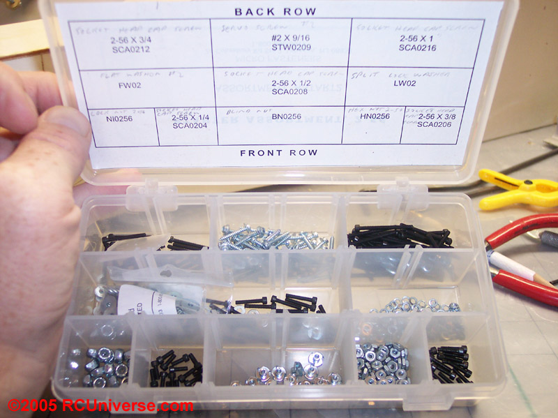

Hey guys, this IS a beginner's forum, right?
Maybe it'd be good to make a couple of details clearer. All the servos I've bought recently included some hardware that I don't see mentioned and that covers a couple of details that're being mentioned here. I took a picture of one servo with that hardware.
This servo mfg provides 3 pieces for each servo mount hole. There is a rubber grommet, a screw, and a brass fitting. That brass fitting deserves the focus here. If you look at the picture it shows the closest mounting hole having a screw in it, and the brass fitting is partially extracted.
The fitting does a bunch of things for us.
First off, it makes how tightly you tighten the screw less important. You still have to get it tight enough, but overtightening is less a problem. The brass usually stops the overtightening by resisting. Most vibration mounts have something just like this arrangement. Look closely at the vibration absorbing motor mounts for example.
Secondly, it provides a widened base against the servo tray that will help keep the grommet from squeezing down into an oversized hole. Not a big deal, but it's there.
Third, it helps keep the screw straight.
Fourth, it helps keep the grommet in those servo mount holes, especially the ones that are slots.
BTW, this servo came with screws with widened heads, like they had washers already "welded" on. That's kewl, but it takes away one very useful help that washers provide.
We have a lot of places in this hobby where we need to tighten screws or bolts and don't have anything other than the resistance to the screwdriver to help us snug up the screws adequately. Washers help this like gangbusters..... Especially when we're tightening up a screw that's compressing soft stuff like the rubber grommets.....
What you do is tighten the screw until the washer is no longer free to move about. Flick it with the screwdriver tip to see. When the washer is first trapped, you can still move it easily with the screwdriver tip. Tighten it a bit. Test it again. When the washer is tight, the screw is tight enough.
