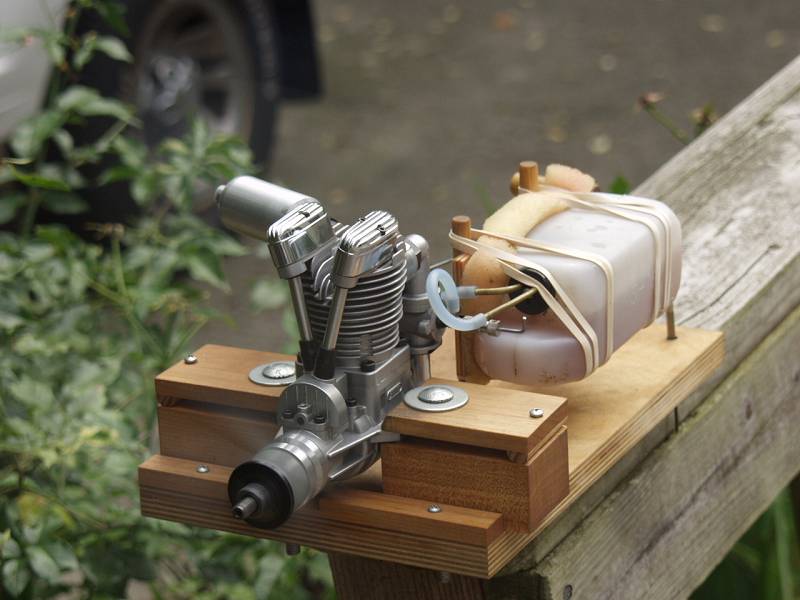

I am looking for some ideas on building an engine test stand. I can't seem to find any threads on this subject, and I am hoping that some out there has some pictures of theirs and details of the best way to build one.

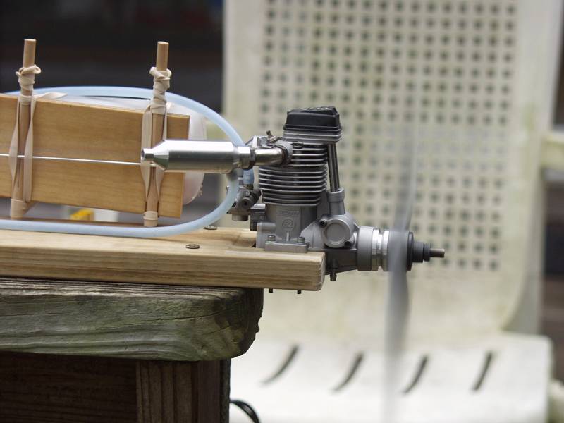

The first picture is a 1 X 4 board that has a notch cut in it to clear the crankcase. The engine is bolted on with bolts from Great Planes. The engine is a OS 52 Surpass.

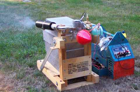

The second stand is an American Hobby Products Jumbo stand. I think that is a Saito 150 I have in it.
Both stands are screwed to the patio railing with drywall buggle head screws.
Enjoy,
Jim

w8ye, I like that jumbo stand. Do you remember what it costs? Thanks in advance.

It was $34.95 but I had to pay shipping. I'd allow $40?

They make a standard, the Jumbo (In the picture, 61 and above) and then the Mighty. They also make a torque and a thrust one.

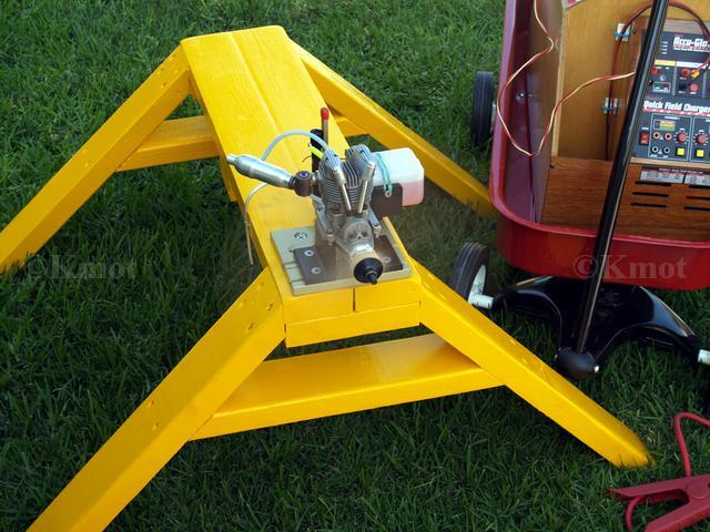

The first picture is a fancy home made saw horse with a PSP stand mounted on it and the second picture is a American Hobby Products Mighty stand.
Enjoy,
Jim

w8ye, Thanks for the quick info, it's a nice looking stand but a bit too pricey for my liking. I'm not above borrowing their design though & building one just like it for less than $10.
