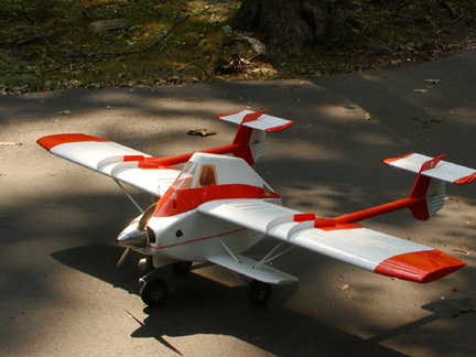

This is a mini/micro servo. You are pushing the limits on the gears in them. Be aware that the gears are a THIN nylon with small teeth. Agressive manuvers and/or sudden strain have an excellent chance of stripping them.
The 37 oz torque SHOULD be OK PROVIDED you are doing Sunday type flying. Aerobatics and 3D manuvers will most likely push them over the edge and they will strip. If you need small servos check out the Bluebird MG servos
http://www.balsapr.com/view.asp?id=V443293&pid=T886880
I have used these particular servos in 46 powered planes.
See photo.
Hope this helps.
