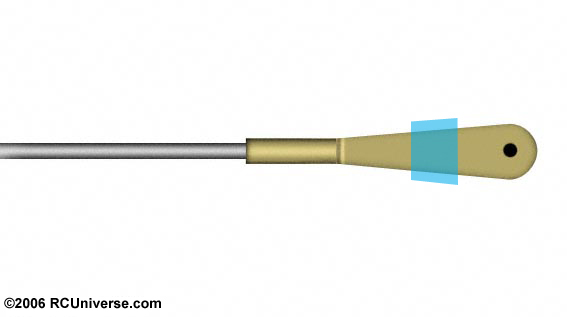

Even if you do upgrade to metal clevis you need to put a piece of fuel tubing on the clevis to keep it from opening up accidentally. But having trained more students than I care to count (and seeing many different trainers) I can tell you that the supplied plastic clevis that come with the trainer are more than adequate for this plane. Put fuel line keepers on them and you'll be fine. Upgrading to metal clevis is just spending money that you could spend elsewhere.
Hope this helps
Ken

dont worry about any of the hardware its more than fine although as noted use the fuel line for safety take notice of the small barbs on the clevice thats so the fuel line doesn't slip off. you might want to pull the AFS sensor out and seal the hole with monocote as the fuel from exaust will soak into the fuse were its exposed . I never used the AFS ever but didn't remove the sessor until I noticed the fuel soaking into the fuse weakening the balsa
