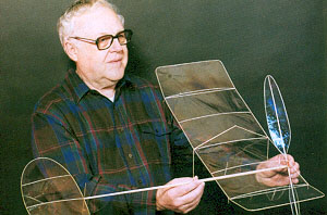

Believe it or not Bruce, that's how the Indoor guys cover those fragile little indoor jobs they fly.
I don't know the exact proceedure, but it's something like this:
They get a bucket of water, pour some liquid in (which floats as a film on top), then they dip the wing into the water and the film clings to the framework.
Wouldn't it be great if we could do that?

Would be nice. Doubt it would last long on a Kaos though. [:@]

Mike B, It seems to me with the indoor FF, that the Microfilm is pulled off of the water or what ever liquid is used, with a big loop and then the microfilm is placed on the model. Dipping the wing in water with these fragile models would induce warping like you wouldn't believe!

Mode One, I was wondering how they got past the warp issue.
