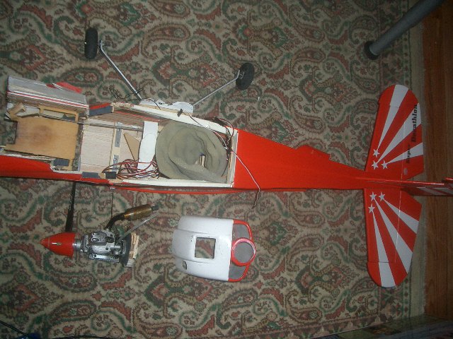

A great plane and a very gentle and forgiving flyer (or so I thought)...I had an unfortunate midair encounter however with a low wing racer (how unfortunate is that?!) which cut my wing in half and the poor decathlon met with the ground abruptly!
As you can imagine I am not an experienced builder, so would appreciate any help in rebuilding this...
I have an extra wing (the guy that sold it to me had it), so the wing is not a problem, however the fuselage needs a new firewall and have no idea how to built one with no plans, from what material I should built it from and most importantly how to secure it on the fuselage!!
I am attaching some pictures and any help/tips from experienced builders out there would be appreciated!
Many thanks and beware of low wing racers sneaking behind you (I beleive the Japanese called them Stukas!!),

Well, luckily, it's only balsa and plywood! The firewall is most likely 1/4" aircraft plywood, available from the LHS. To get the correct pattern you could (A) piece together the crashed one and copy it, (B) find someone that has the kit and copy theirs, or (C) order a new one from the manufacturer. Most firewalls are glued to the fuse sides, top and bottom (inset into the fuse) and supported on the inside with triangular balsa stock. You may want to look at somebody's kit built plane that has not been covered yet. (Ask around at local clubs), to see how the firewall is built in. Most any type plane would do as an example here, they are all similar. Hope this helps.
Sorry for your loss, Dimitris. I saw a similar mid-air several years ago at the local field. A large Waco was doing a low fly-by and pulled up in front of a VERY FAST-moving Sig Kobra coming up behind him. The Kobra center-punched the Waco's right wing panels. The Kobra's spinner chopped the wings in half, with the expected results. The Kobra landed safely with only minor damage to one wing and the spinner cone. The Waco was totalled.
That's bad damage, but it's fixable. Strip ALL the equipment and hardware out of it. Lay the fuse on the workbench. Note what wood is used and where it's used and go buy the same stuff from your LHS. Use the old firewall to make a pattern. Even if it's in several pieces, you should be able to piece it back together enough to get a useable pattern from. Strip off all the covering from the damaged areas. Some pieces are broken but still attached to the rest of the fuselage. Work these back into place and start gluing, using thin CA. Begin fitting new pieces into place. Glue then in, working from the back to front. Use splices, reinforcements, and thin CA. When you get to a piece like the landing gear plate or firewall, clean up the places where it goes with a #11 and sandpaper and fit a new piece. Use thin CA first, and reinforce with tri stock. After the thin CA soaks in and saturates the joint, run a little thick along the seam. Use reinforcing strips wherever you join two broken pieces or add a new piece. Work slowly and think a step through before you do it. Dry-fit everything before you hit it with the CA. Finally, fill and sand the exterior and recover. Reinstall all the equipment. If you're a not very experienced pilot, I'd advise having a helper with you when you test fly it, and I'd also advise not test flying it when spectators are present. The trim may have changed a LOT from before the midair.

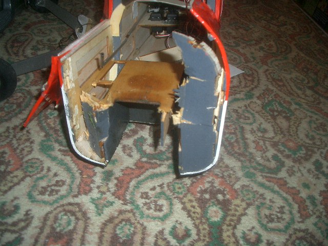

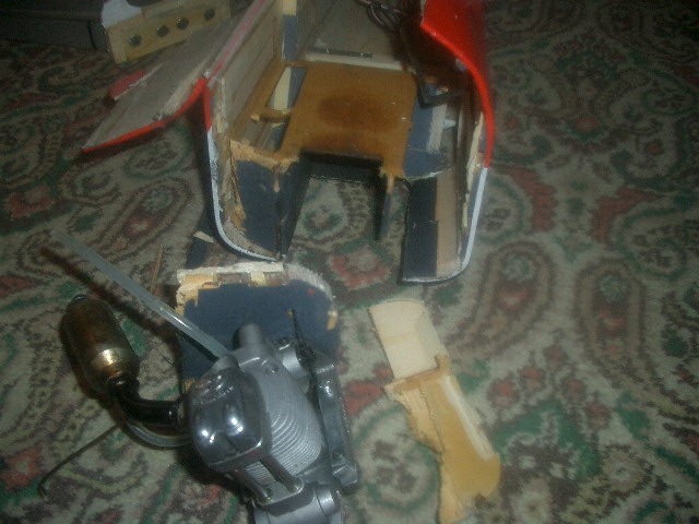

From the pictures it looks like to me that the firewall broke into two pieces. About 1/4 of it still attached to the fuse and the rest to the engine. Look at the blind nuts relative to the edge of the piece left.
I would make a new firewall using the two old pieces as a template.

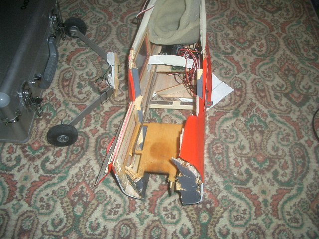

Thanks a lot for all the answers. The more I look at it and the more I read your answers the more I think I should give it a try. I was ready to scrap the plane and get a new model.
I was a bit sceptical of epoxying things together as I do not know if they are going to hold. I am attaching some more photos for your consideration.
The firewall is broken into 3 pieces, so I guess it would be safer to try and rebuilt this. Now mounting the firewall, the fuselage is broken where the firewall was mounted as well as where the support behind the firewall is (shown in the photos) The fuselage is also broken where the landing gear mounts whith the plate detached and still attached to the landing gear.
Would just epoxying all this together, together with some supports be enough?

DO NOT USE EPOXY! Why? It's heavy. It takes a long time to cure. Unless you use really a slow-set (read 24 hours) type and thin it a little, you can't be sure of woodgrain penetration. You'll have a surface bond that will pull off under load. Use thin and thick CA. It will wick into every woodgrain within 1/2" in all directions from the spot you apply it. It's lighter and stronger than epoxy, too.
