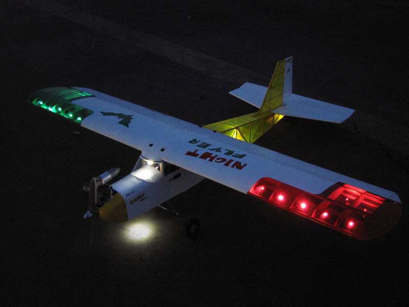

Here is a Kadet Senior from a kit, not just another ARF. Bombay doors, camera mount, tail dragger and lot's more.
