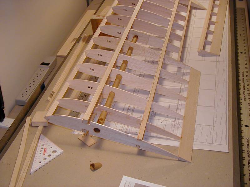

Here is an older picture that shows the cutout for the strip ailerons, I lowered the dihedral to about half the original.
I cut 3/8" off the aft of each rib where the ailerons go and added a 3/8" x 1/2" strip for strength and hinge mounting.
I mounted servos in the wings on a removable plate. You can see the tubing I installed to run the wiring through (Estes T5 rocket body tubing, 1/2" Dia. worked out great)

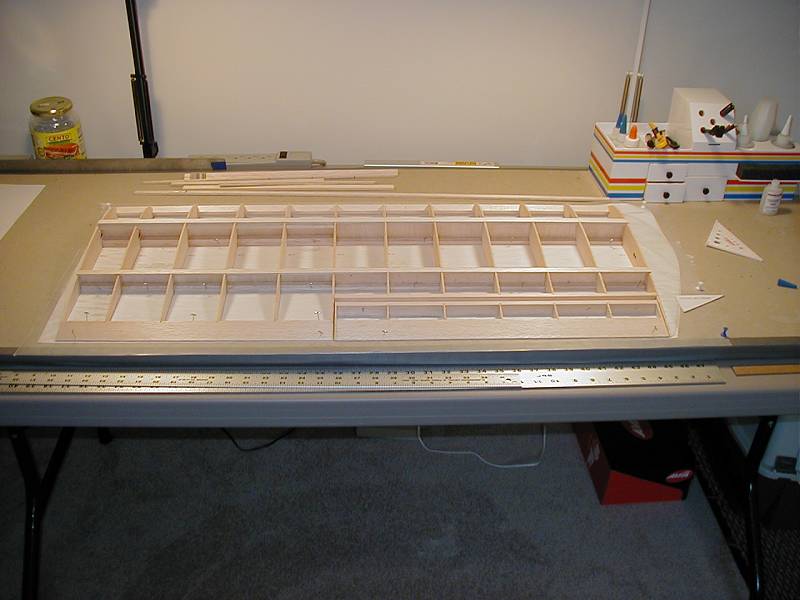

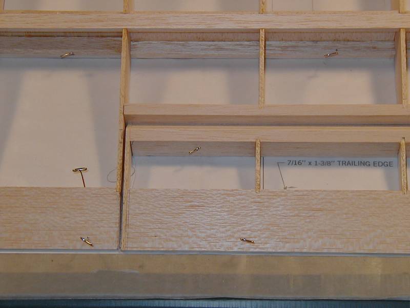

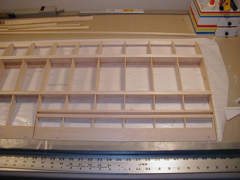

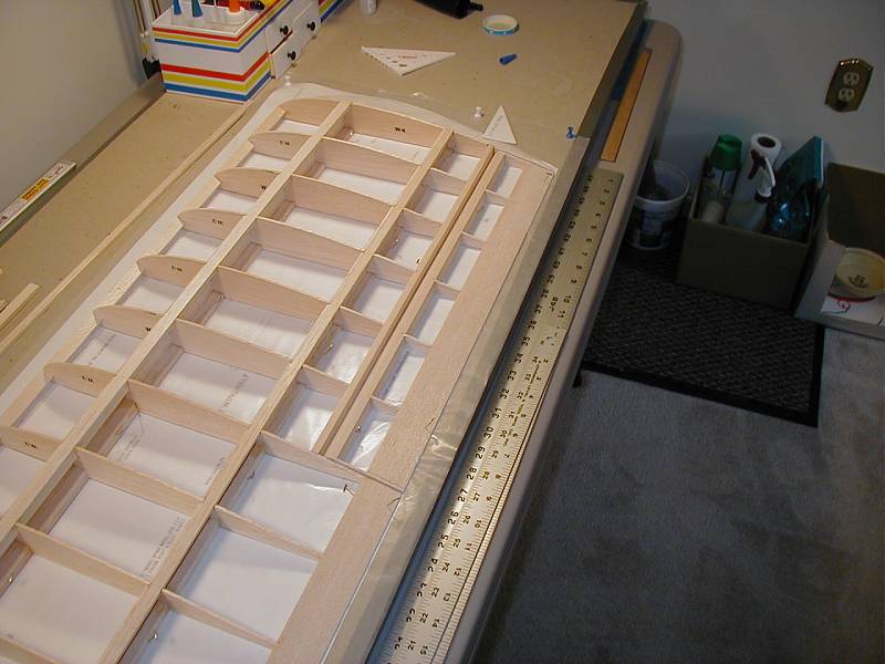

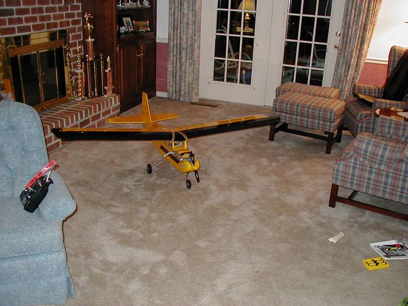

I built my Kadet with the stock wing with recommended dihedral, after about a month of flying I decided to build another wing with ailerons and 1" of dihedral. I think it flies great with ailerons and the 1" of dihedral. Here are a few of the pictures of the plane with the first wing, and a few pictures of the new wing before they were joined and covered.
