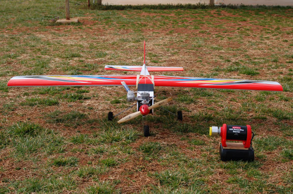

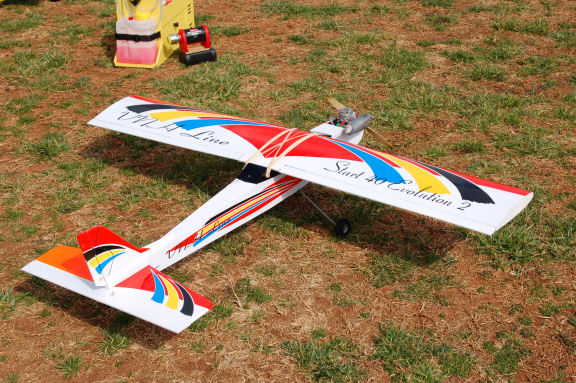

Can you take out the dihedral?
You betcha.......
You can take out so much that you can call it ANHEDRAL.
This "trainer" is actually sold with sort of a wing joiner and root rib orientation that the wing glues together with something like about 1 degree of anhedral. We've gotten 5 or 6 of these at the field and they turn out with different amounts of "droop". The pictures are of mine. I cut a joiner that would fit the wing boxes (they were different dimensions inside) and give 2.5degrees of anhedral. I had to sand one the root ribs in a couple of places to get them to match up. And got a full 2.5degrees.
It actually rolls into rudder turns just like dihedral wings do!
It has a self-righting characteristic, but that's to be expected somewhat from high wings.
It has actually served fairly well as a trainer. I've had a low-time flyer who is really shaky with takeoffs and landings fly it and it was no extra effort for him.
