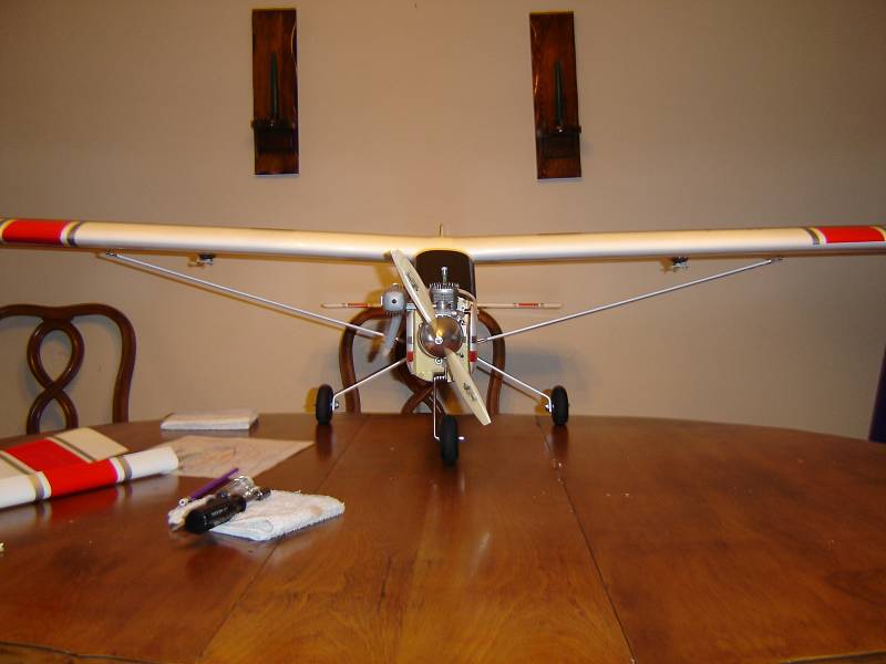

Ok, there was a post or two on here at one point that stepped through the process of getting rid of some or all of the dihedral in the nexstar wing...but i searched for it and came up empty.
The idea is simple enough, bend the rod...fill the gap...but can you still use the wing joiner they give or do youhave to fabricate something to work now?
any help is much appreciated.

On the inside of the joiner you will see small ribs thicker on one end thinner on the other. Use your dremel to grind them flat, then bend the bar a little at a time till it fits.

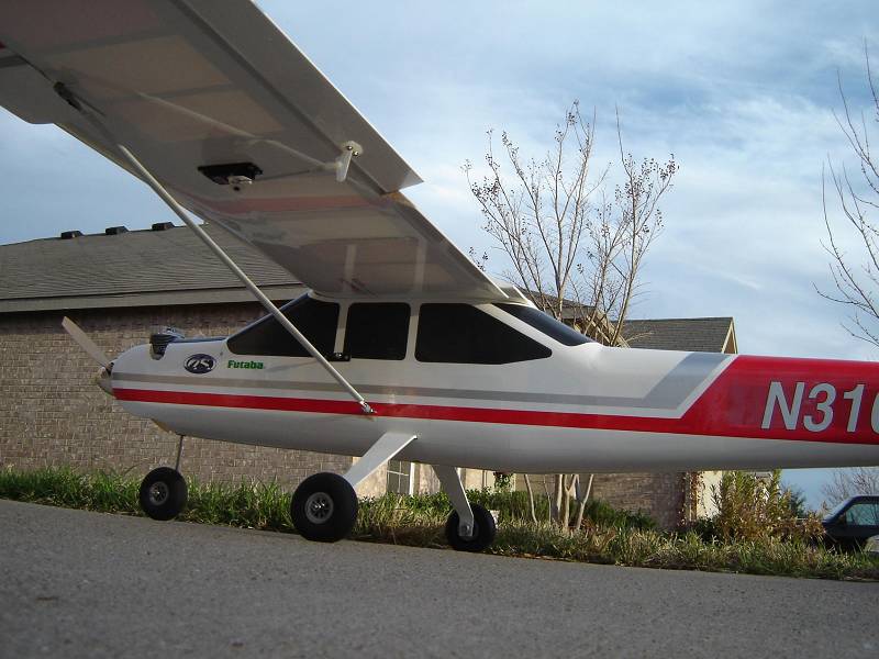

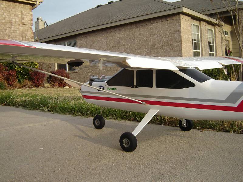

I took the much of the dihedral out of my Nexstar by just bending the bar just a bit. A little goes a long, long way. Then, I fashioned wing struts to give it added streanth, plus they look cool. If you don't grind in the joiner, it's almost nesessary for the wing struts becuase of the somewhat lack of "rigidity". But to me, it just looks better with them anyway and it hasn't changed the flight characteristics at all. Here is a picture of it.

Hmm...wing struts like that something you can find premade, or did you make them from linkages or something?

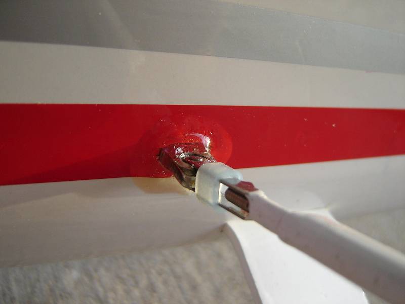

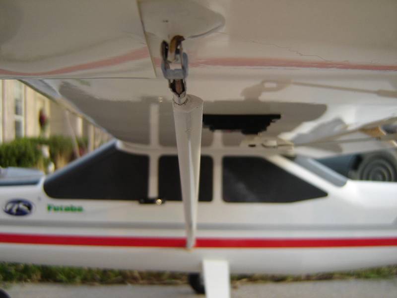

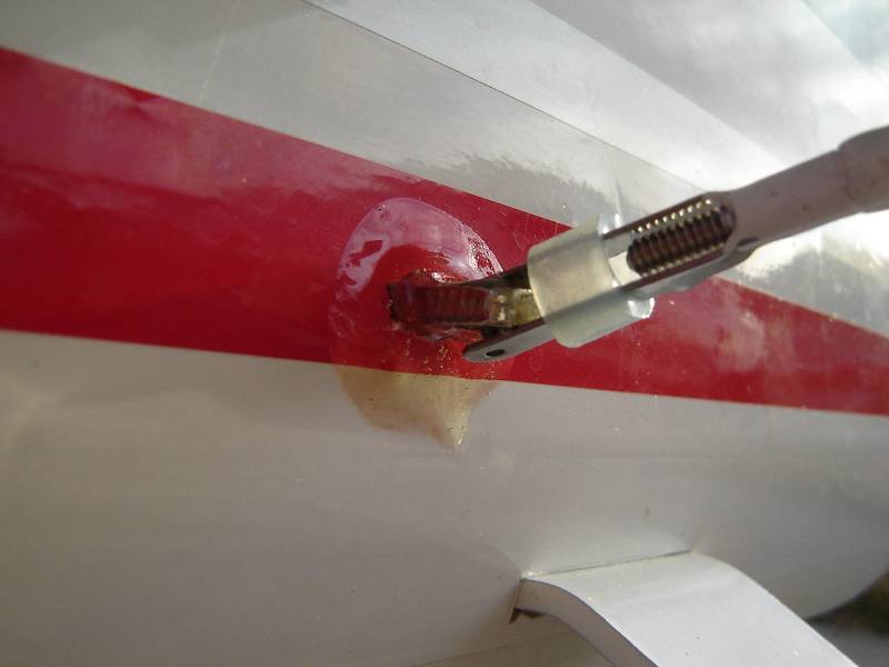

I made them myself. I went to the hobby shop and got two long aluminum hollow rods that are "tear drop" shaped. You can use round ones to. Then I epoxied screws into each end. Onto those, I screwed on steal clevises. On the wings, I epoxied brass screws with a little eye in them. I have no idea what to call those. I painted them all with a gloss finish and walla. If you wan to see closeups, just let me know, I'll pose more pics.

As promised. Here are some detailed pics of my Nexstar.
