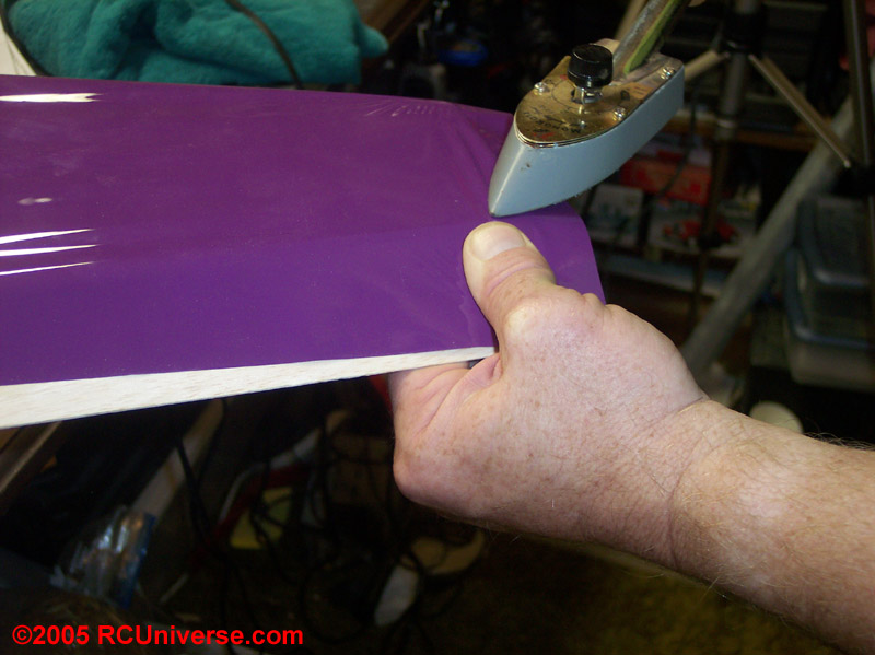

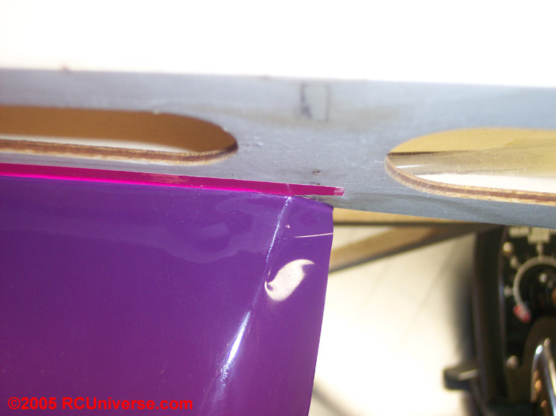

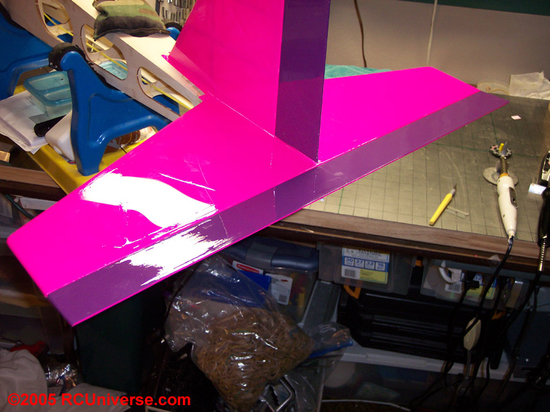

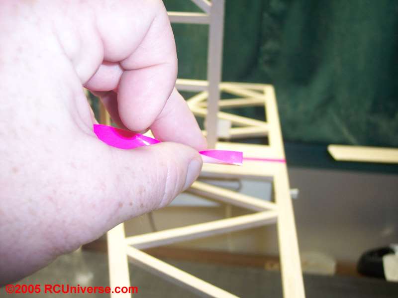

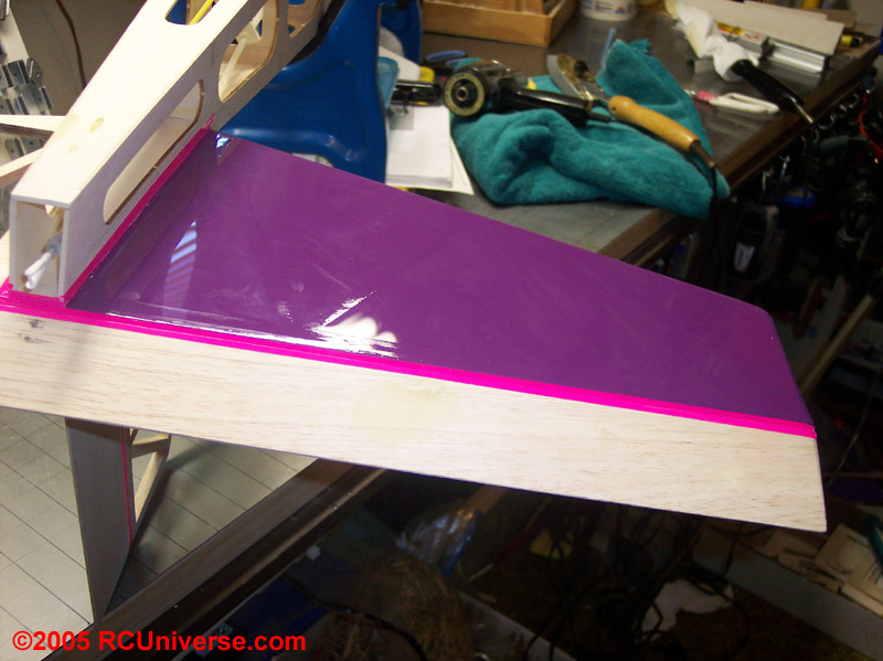

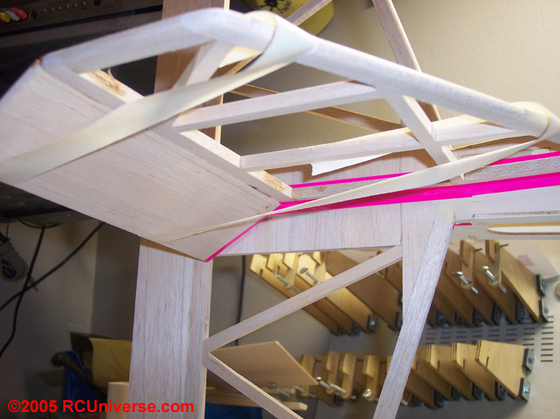

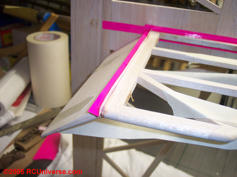

striderjg,

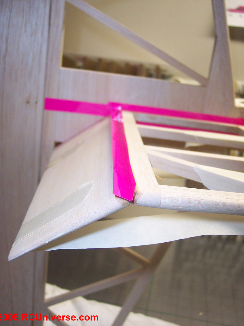

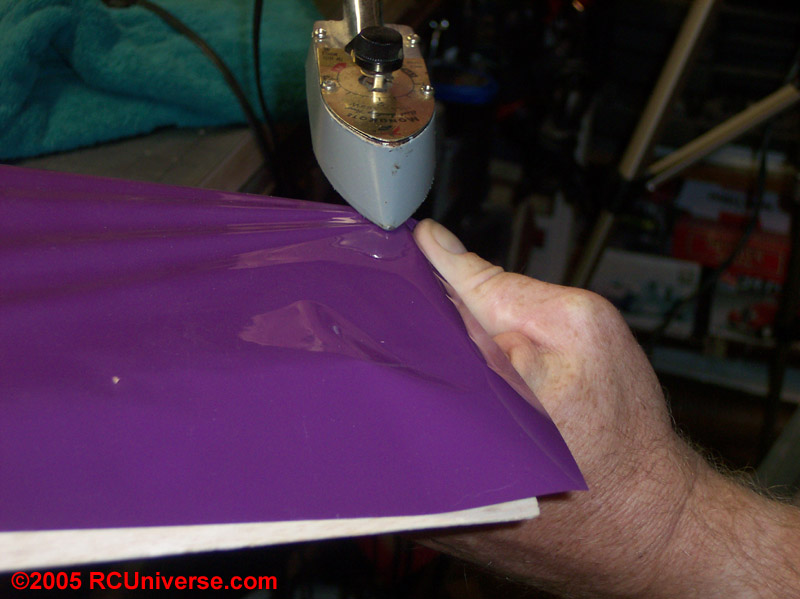

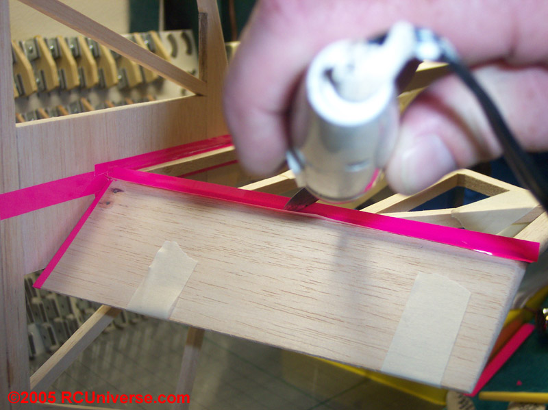

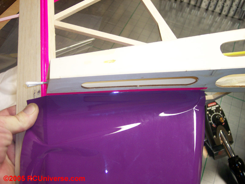

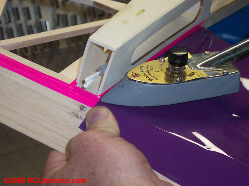

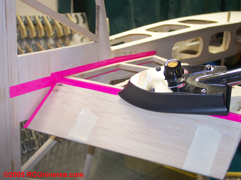

I always attach the control surfaces before I cover. Cover the gap first, and then do the covering on the rest of the surface after that. Take a look at these pics to get an idea of how I go about it.
Ken

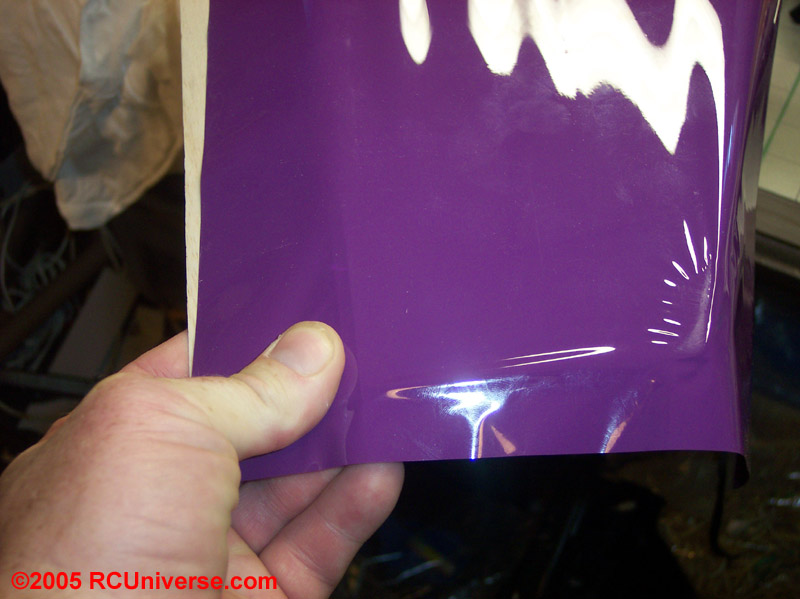

Hey Ken the trim on the hinges you it to both sides right? I'm at that point in your pic's on my plane and was wondering the best way to do the hing area's.
Another thing... How do you keep it from rolling up some much? Every time I peel the backing off I fight it the whole time trying to get it tacked down.
Thanks\
Randy
Old 03-14-2006 | 04:16 PM
Joined: Nov 2004
Posts: 11,701
From: Memphis, TN
Default RE: covering...
Fold it and make a crease.
Old 03-14-2006 | 04:45 PM
RCKen's Avatar
RCU Forum Manager/Admin
Posts: 28,247
Received 31 Likes on 27 Posts
From: Lawton, OK
rsCVN-71,
Yes, I do both sides of the gap.
And what Bruce said. Yes, fold it in half.
Ken

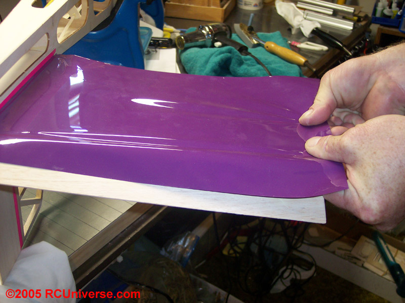

Now how do I take care of the rolling up after I peel the backing off? Makes it a real pain in the a#$ trying to get a long run done and it keeps rolling up on all four sides. Seems like everytime I pull that backing off large or small pieces the covering just rolls up tight. The wife said I sound like I'm back in my navy days.. @$*# #$%@ %($%)_# %&U@)%* [:@]
Randy
Old 03-15-2006 | 08:16 AM
Joined: Nov 2004
Posts: 11,701
From: Memphis, TN
That's what the wife can do, have her help hold it for a few seconds until you can get it aligned and a couple of points tacked in place with your iron. Otherwise, just fight it. You may be able to put a couple of pieces of masking tape on to help also. You'll get used to it in time.

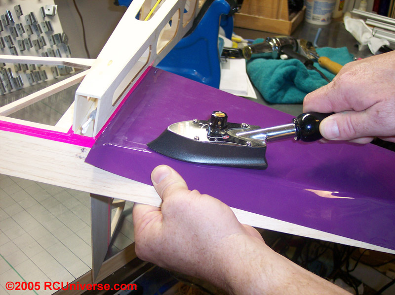

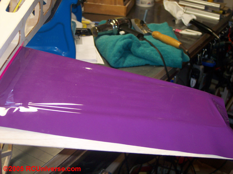

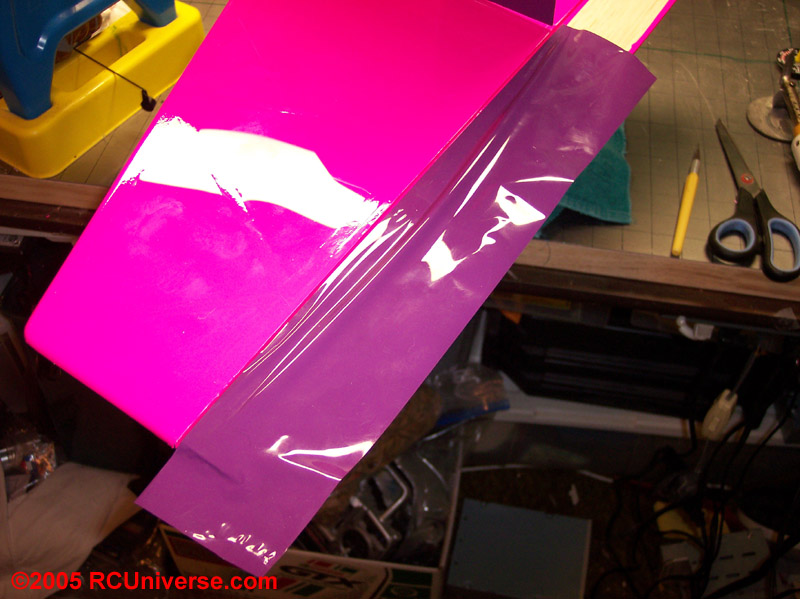

rsCVN-71,
hmmm, that's odd because usually it rolls up before you pull the backing off of it and after you pull it off the covering will usually lay flat. Anyway, the way you are supposed to apply the covering will take care of the rolling up issue. The way to do it is to first tack one corner down, and then move to another corner and pull it tight and tack it down, then the 3rd corner, and finally the last corner. Make sure you are pulling the covering straight and tight before you tack the corners. Now you can back and finish applying the covering without it rolling up.
Hope this helps

After you tack the corners, like Ken said, seal down the edges all the way around. Do this sort of like spot welding or stitch welding. A tack here and a tack there all the while carefully pulling the covering out to remove as many wrinkles as you can. Once you have gotten tacked all around, take the iron and go smoothly all around the perimeter and firmly seal it down. Once the edges are down you can turn to the gun and shrink the inner field. Once the inner field is shrunk tight and the last wrinkles are gone return to the iron and seal the field to any underlying structure where required (sheeting areas and ribs/capstrips).
Oh, before shrinking the field, it would be good to finish up the wing tips. Don't want the gun shrinking that material until you are ready.
