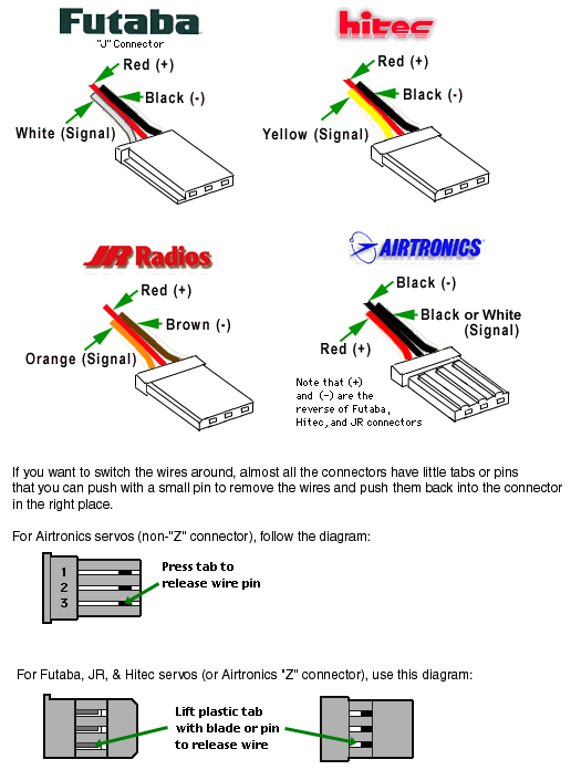

Dave,
Old Airtronics servos aren't "incompatible" with your receiver. It's a simple matter of changing the wiring on the plug to use it with different brand receivers.
Ken

Default RE: Are all servos created equal?
Ken, thats not exactly true, the old Airtronics connectors are also larger and will not physically fit into the plugs on new recievers.
