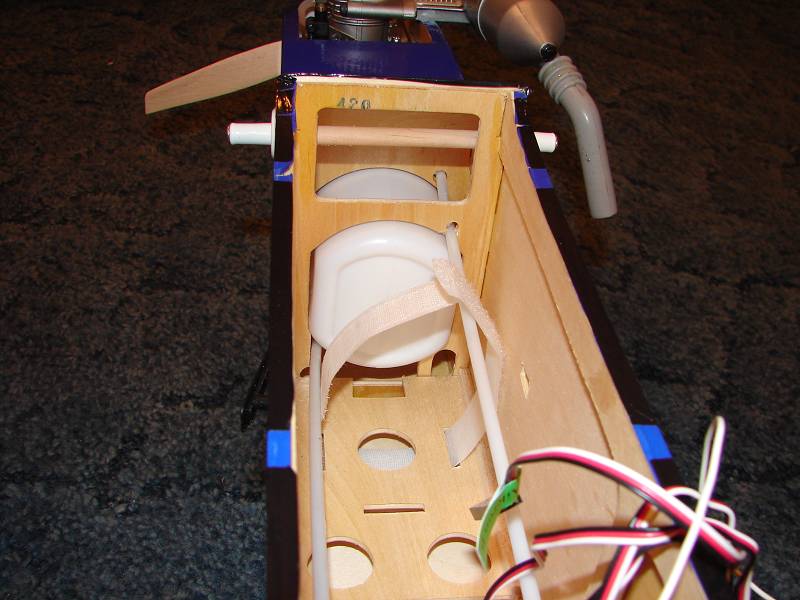

My fuel tank was rattling pretty bad so I decided to put some foam around it. All that was holding it in was a tongue depressor.
In the 1st picture you see I have already taken out the battery, receiver and depressor. Tank is ready to come out as well.
Next there are two ribs and push rods in there so I had to measure and cut the foam small pieces to fit. In the next shot putting the biggest piece in I had to roll it up then slip it through the frames and then let it unroll. The tongue depressor actually came in handy to help me maneuver the foam into position.

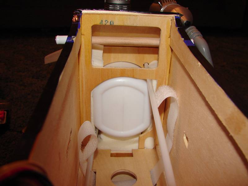

Now here we have the foam all in place and ready to put the tank back in.
Ok now I got the tank in and it is nice and tight. I had to wiggle the tank to get it past the foam but that worked well.
Last shot I put the tongue depressor back in behind the tank and it is really doing its job now.

I just did the same exact thing with mine. The tank was vibrating so much that there was air bubbles in the line, hopefully this will fix it. I crammed foam on all sides of it, I just hope I never have to take it out again.
