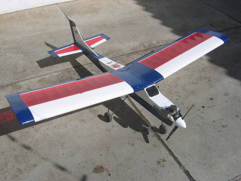

A guy has this for sale locally, 75 bucks, and just needs a transmitter. I hate to buy something like this used, but he said it hasnt been abused, and the engine is new, so I will take a look at it, and hopefully get it. I dont have any information on it yet, and am trying to identify it. Anyone have any idea what it is? If you can identify it, is it a good flyer? thanks guys!

The fin is shaped a lot like the Great Planes PT-40 & PT-60, and possibly every other trainer out there.
What did the owner say it is?
What is the wing span?
I've never seen an ARF trainer in those colors. Did he say it is kit built? Or is it an ARF that has been re-covered?
What engine does it have?
What receiver and servos?
None of this really matters though. Unless it's a pile of dog poop it's worth 75 bucks. If it's built well and straight, one trainer is about like the rest.

The wingspan is 57 inches. the engine is a GP42. Other than that, thats all I know. I can get more information tomorrow when I pick it up. The pictures are crappy, but it looks to be in good shape, and he says that it is. Thanks for the help!

If you could get some better pics it would help but it looks like the old SIG Cadet fom bac in the 70 and 80"s

The Pt-40 has a wing span of 60 inches and a hatch just behind the engine bay. I think it is an older Sig Kadet or Kadet MK II. You might go to the Tower Hobbies web site and look at the current crop of trainers. wwwtowerhobbies.com . All ot the above were good flyers but the original Kadet was a three channel and many were converted to ailerons. You could buy the aileron upgrade parts from Sig. The windshield looks like a Kadet which was carved and rounded.

it could be a sig mk2 without the cowl im not possitive though. if it is trust me its a great trainer and a deal at 70

def. looks like a kadet mark II wich i beleive WAS a 4 channel model. I have a partialy done seniorita at home, and illd say thats a darn good deal if thats what it is.....

Definitely a Kadet MK II with out the cowl. Have on hanging in my garage just like it. I have flown several trainers and they are by far the best ones I've flown.

Well, I just got home from picking it up. I'm pretty happy with it. Doesnt look like its been crashed, and doesnt really look like its been flown much, or someone kept it very clean. I feel like I got a good deal, and I'm sure I will enjoy it. I'd say, from looking at pictures, its a Sig Kadet, maybe an older one. Here is what it came with...
GP 42 engine, new
Airtronics 92265 rx, fm, having a hard time finding info on it. I guess its an older one.
Airtronics 94394 servos.
Its all there, I will have to find a Tx to match the rx, or just get one of each for it. The covering has some holes in it, and they look like cigarette burns, honestly. I'll patch it for now, but would it be possible to remove the old, and recover it? Here is a picture, it aint much to look at, but it isnt supposed to be either!
