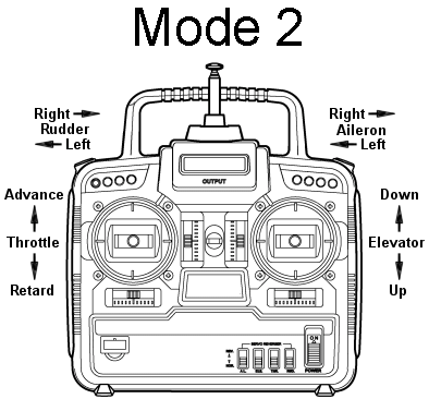

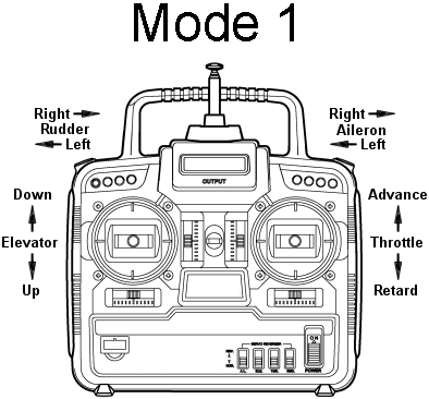

I am trying to find out which mode is which ..I use Fms and a gamepad my current setup is throttle and rutter on the right stick and aileron and elvator on the left stick ..Which mode am i flying?

See diagrams
Ken

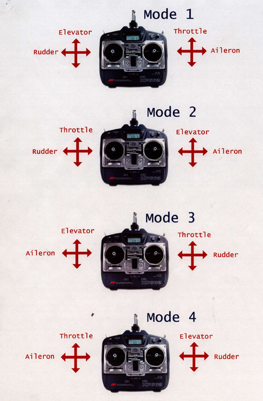

ORIGINAL: brian8474
You are using Mode 3 which is a left-handed version of Mode 2
From Futaba's web site.
-------------- Left stick-------------Right stick
Mode 1------elevator rudder------throttle aileron
Mode 2------throttle rudder-------elevator aileron
Mode 3------elevator aileron------throttle rudder
Mode 4------throttle aileron-------elevator rudder
Photo snagged from a similar post a while back in the radio forum
