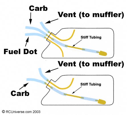

Can anyone direct me to a site that shows the pluming of the fuel lines for my P-51

basically the vent line, goes to the top of your tank, hooks to the muffler. the line with the weight on it (clunk) goes to you needle valve. if you have a thrid line its for refueling. if the refuel line and the line that goes to the needle valve both have clunks they can be reversed

See diagram. Let me know if this isn't what you are looking for

opps, looks like I forgot the diagram.
Here it is
