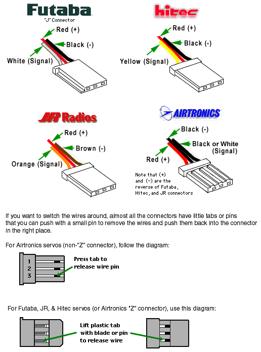

Another FYI. You can use the older Airtronics servos but you have to rewire the plug on them. It's not difficult at all to do. In fact, you can use just about any servo out there with any brand of radio as long as you pay attention to how the plug is wired.
