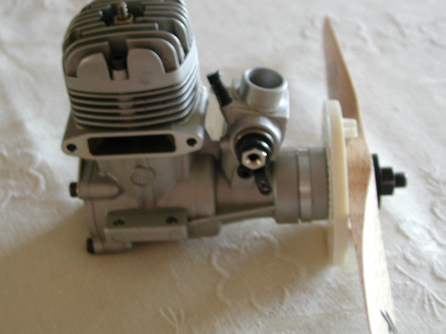

I am putting together a Sig Somethin Extra. I am at the point of mounting an Os46fx and I have run into snag. Being the first time of building an arf, I don't know the correct way to mount the engine to the mounting arms. I have the arms on the firewall, but I don't know if they are correct. If I put them on one way, the engine sits high. If I turn them over the engine sits lower in the fuselage. Which way is correct for these plastic(I think) mounts? The second question is about placement of the engine on the arms. From what I've read, the spinner backplate should be about 1/8 to 1/4 inch in front of the nose of the plane. However, if the engine is placed all the way to the rear of the arms, the engine (spinner backplate) still appears to be to far out in front of the nose. Third question- how do I actually attach the engine to the arms? I know the engine has 2 flanges with holes, but do I drill through the arms with a drill bit and then put some certain size bolt with washer on top and a matching nut on the bottom of the arm? I can't tell if the flanges have threads in them. And last if the firewall has the correct thrust angle built into it, how can I be sure that when I put the engine on the mounting arms that it will be the same as the firewall angle? Thanks.

First, the holes in the engine flanges aren't threaded. You can either drill completely through the mount arms, and bolt the engine in place with washers and nuts as you indicated, or you can drill and tap the engine mount (which is glass-filled nylon) for 4-40 bolts. That works for me, but some people don't recommend it, preferring bolts and nuts.
Second, placement of the engine on the arms should be more a function of balance than distance of the spinner from the nose of the plane. If the engine sticks out more than 1/4", so be it--it's not as important as a well-balanced plane.
The thrust line of the engine (how high it sits) is indicated by the bottom of the engine flanges. On my SSE, this is almost exactly at the most forward point of the fuse sides. Your pictures of the mounted engine look correct. As for right thrust, if the engine sits square on the mount (i.e you drilled the holes nice and even), the engine will be correctly aligned. A little off isn't anything to worry about.

I agree with Nickj on all counts-except I'm one of the group that prefers to bolt the engine to the mounts with socket head bolts and those nylon insert nuts. I don't take chances with the vibration created from these engines. As far as the engine sitting on the mounts high one way and low the other, try to line up the height of the carb with the centerline of the fuel tank. That will determine which way the mounts should be. Good luck on the plane-and check those low rates!

There is an excellent little tool that's sold in most good LHSs. It's a "hole center marking tool". It actually has a small drill as it's marker. And it's got a tapered piece that centers the thing in an engine's bolt hole. You just have to make sure it's straight up for it to accurately mark. It now sits with my block of wood and pencil.
