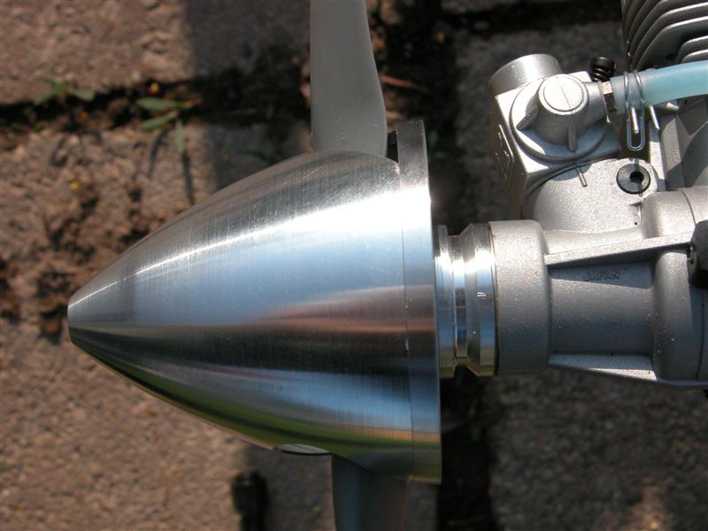

I am having problems with my spinner and prop flying off the engine. I have flown a few airplanes before, but this problem is making me feel like a noob again. I have an OS .50SX engine, an aluminum spinner, and have tried wood zinger props as well as the APC prop shown in the photos. It has never flown off while I am in the air, but it does about half the time I try starting it (with an electric starter). I have on suspision, and have shown photos of it.
Here is the entire assembly:
I am thinking it is this piece that mates the spinner back plate with the engine shaft.
You can see there is a notch on it.
If you look at the engine shaft there is also a notch. You can even see some metal shavings inside it. Should there be a piece that holds these two notches together? This engine is brand new and I have always had this problem. I don't know what to do. I am absolutely positive that I have everything tight enough. I cannot get it any tighter without stepping on the wrench.

looks like its missing a woodruff key (it should be in that slot) if I'm not mistaken

[X(][X(][X(] Yes, first off there should be a keyway in there. It looks like a little orange slice. Except silver in color.That is a must have. Second , make sure that the engine is not set to rich or that you a have a fuel siphoning problem. Where fuel fills the carb after shut-off. What happens when you try to start it esp. with an electric starter is the engine hydro locks thus spinning the prop nut and prop loose. You can always check this by 1) looking in the carb or 2) give the engine one flip front with a chicken stick to make sure it turns with a pop and not resistance. When starting with an electric start remember to turn the spinner all the way clockwise to the compresssion stroke and then hit the starter ,that gives some speed build up and help to the starter.

I lost one in my lawn from a .50SX. The correct key is not a half moon. It is more pointed on one end and can be installed wrong.

Many of the woodruff keys are metric and most do have a flat at one end which normally goes against the engine...you should not be able to install it incorrectly and still get the hub on. A small amount of locktite will help to hold it in place, they are very easy to lose so a spare is a good idea. OS engines use this method also and I am sure there are others as well. Missileman is correct, they are normally made of an alloy which acts as a shear pin to protect the engine in case of a prop strike. Using the wrong material or size will casue you problems....

The Woodruf Key fixed everything. The engine starts much easier now and the prop/spinner stay on. I found out the prop speed thing was caused by the thickness of the Zinger wood props. When replaced by the same sized APC prop the RPMs went up by 3k.
