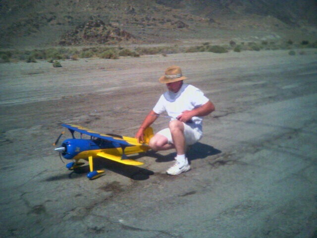

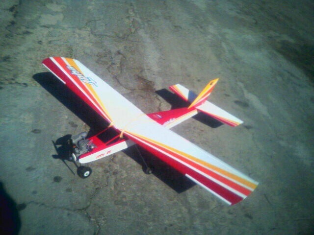

i learned on a alpha trainer with the extra cra---on the engine, the guys above are right in all respects but you sound like you just began learning to land, just be ready for a little more speed with a 10x6 2 blade, the evo 3 blade is real slow compared to the two blade, you can do it but just be ready and good luck
the alpha is the same one i started with 2 years ago and the bi-plane is what i fly today, so hang in there you will love it!!!
