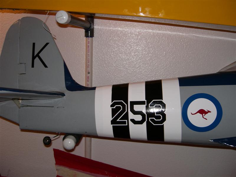

I've had great succes with these guys. Several of the people at our club including me has delt with these guys for a couple years. They turn out great stuff on marginal info.
they made these from a horrible low rez pic off the internet and gave them them my kit name and scale

trippy. I got 6 aussi roundels. the invasion stripes for the wing and fuse. 2 tail number two fuse number and 2 magnificent obsession letterings for the cowl for 30 bucks and a 1 day turn around on my sea fury[sm=surprised.gif]
My balsa USA cub I got 2 sets of 7 inch wing lettering 2 sets of rudder lettering, 2 cubbies. the lightning side stripes and Continental dummy engine lettering. couple piper insignias, the wannabe lettering for my slow quickie for 45.
Your local sigh shop would cut them outta vinyl, and vinyl is a heck of allot easier to apply and nitro will not effect it in any way
