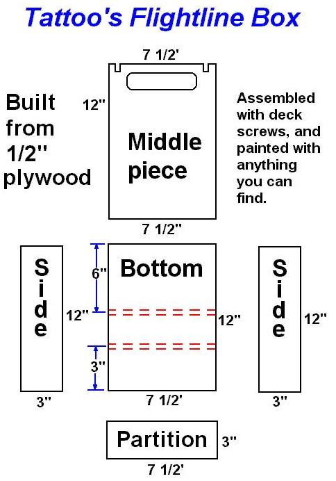

Here is a picture of a simple flight box with a plan to build it. It shows the basics. One thing I didn't see on your list were any screw drivers, pliers, wrenches, etc. Get a glow plug wrench.
