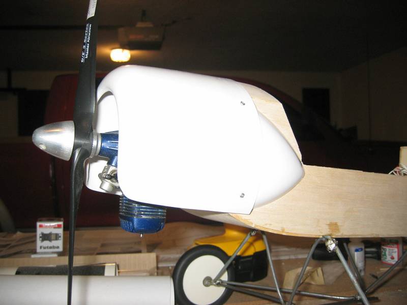

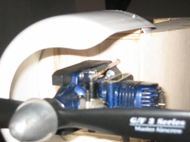

I'm nearing completion on an BUSA Eindecker 40. I've got an OS .40 LA engine mounted upside down inside a cowl (see pix). The problem is I don't know which muffler is right for the job. I need some specific suggestions as my only option is ordering over the internet and I MUST be sure it's going to work before I order. All I want is something that fits inside and is a muffler. Pretty easy, huh? I've pondered on inverted, compact, and even homemade, but I'm just not sure what the best option is. Please help!!

I've been doing that. I've checked many sites but I'm a little overwhelmed with all that's out there...plus I haven't found anything that's been labeled "Inverted" for the LA. That's my main problem. I was hoping someone would know of something offhand, either a specific muffler or where I could find one. Any thoughts?
Bryan
{Edit} Just looking at my own pics, how about a tuned pipe running down the bottom? Is there a way to get it attached to the muffler port and still run rather streamlined down the bottom of the fuselage?

I can't tell from your pics if the engine might fit sideways indide the cowl. If it will, consider a pitts style muffler that will exhaust down and back. The muffler for the OS 32 will fit your engine.

Also keep in mind that inverted two strokes are not the best idea. Some people get away with it, but some have problems until the give up all together and go with a horizontal mount.

Ya, definitely don't be trying to run a 2 stroke inverted. The engines just don't like it and most will quit after a few minutes of running.
They don't mind running side ways with a pitts muffler.[8D]

Well, I guess that answers that question! Thanks for clueing in the newbie!! [sm=spinnyeyes.gif]
I'll change it to sideways....2 questions I have now. A 4 stroke same size...more power or the same as a 2 stroke? And, do I need to change the mounting holes for going sideways, or leave centered as is?? (My gut says leave it centered since I pretty sure that lines up with the motor shaft).

Great info! My 2 stroke has a square mount and after looking at it again, I wouldn't have to move the holes. However, there is not enough space under the cowl for it to be sideways or right-side-up. I guess I'll make the change to a 4 stroke, and I'm going to go a little bigger since I'm flying at very high altitude too (about a .90 or so). Anyone interested in an excellent condition used OS .40 LA? I'll probably put that in the classified's area soon. After all, that's where I got it!!! [8D]
