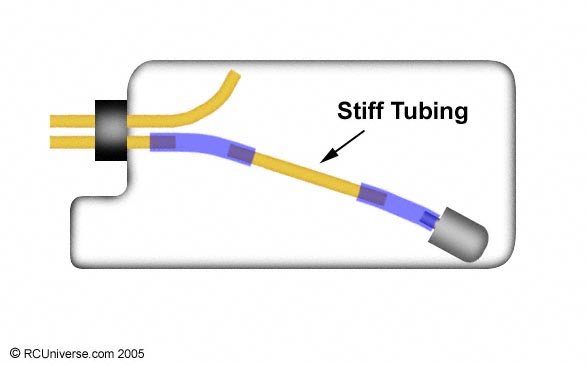

I have a new Thunder Tiger Pro 46 which cuts out in a 3D move. Such as a roll or loop. Does the fuel in the tank stay at the back of the tank when performing a loop or a dive.
I was told that the fuel line inside your tank needs to be flexible enough to move to the front of the tank when the nose is down, as in a dive. But I don't think this actually happens.
I think that centrifugal force keeps the fuel at the rear of the tank.
I agree with Dr1. The fuel line inside the tank should be flexible enough to move freely to all 4 back corners of the tank, but should NOTbe able to fold forward. An easy way to prevent the line folding forward, but retaining the flexiblity is to put a piece of brass tubing in the middle of the fuel line. If your fuel line is folding towards the front of the tank, fix that.
Also, just a quick clarification: a simple roll or loop does not really constitute "3D". And a plane with a proper fuel set-up will not cut out in 3D moves, much less a roll or a loop.

Dr1 is correct, the fuel line should never move to the front of the tank. In fact, I usually put a small piece of stiff tubing in the clunk line to keep it from moving to the front of the tank (see attached diagram). When you are in maneuvers like you described inertia will keep the fuel at the back of the tank.

You might want to check your tank. I was having a problem with mine, I was getting only about 1/2 the time in the air, and whenever I went to a nose high attitude the engine would sputter and stall (interestingly enough, in a simple, tight loop the engine was fine). I took the tank out of the plane and found that the hose the klunker is on came off the brass tube. When I'd go to a nose high attitude all the fuel would go the back of the tank, and the brass tube would be out of the fuel.....so.....no gas, no go.
Since I fixed the tank it's been working great.

The problem with the fuel stiffner is that when you have approximately 1/3 of a tank left or less, and you go nose down, the engine can become fuel starved.
The thought is that you don't want to have the clunk stuck at the front of the tank where it can get lodged using standard tubing.
However if your tubing is flexible enough (you WANT thinner tubing for this) this should not be a problem at all, and you CAN permit the clunk to travel forward and rearward freely, provided that it cannot wrap around the fuel inlets themselves.
A longer piece of inlet tubing can prevent the latter.
You should always take the tank out and make sure that there is absolutely NO way that the clunk can get stuck and try to make it get stuck as much as you can, to check.
Many of the commercial tanks, such as the Dubro tanks, come with the thinner tubing that permits forward movement of the clunk, while prohibiting it from wrapping around the inlets or getting stuck.

If your fuel in inside your tank is too flexible and your clunk move forward it will pinch your line. A pinched fuel line will kill your motor. If you are running lean it will kill it almost instantly.
If you are suffering a lack of fuel it may be evidenced by bubbles in your fuel line. Check it after your dead stick landing.

Pull your tank and confirm that the klunk can easily move to all 4 rear corners and that it can't move forward, and potentially pinch closed, when the nose is down. Also confirm that the klunk doesn't hang up on the rear of the tank as it's moving around.

The clunk on any type of line will not function reliably if it goes to the front of the tank. The flameout situation is a mixture or mixture /glow plug situation.
