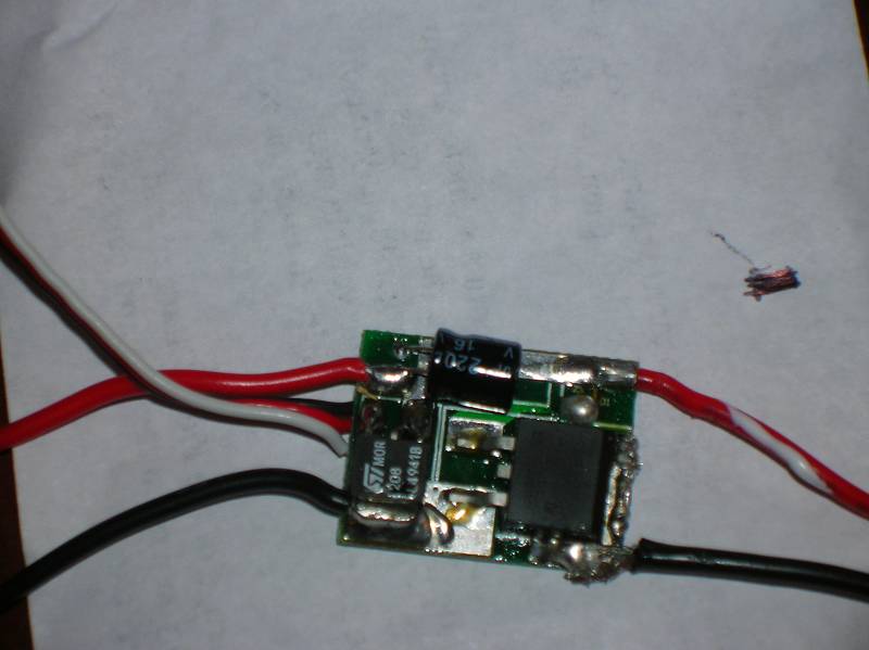

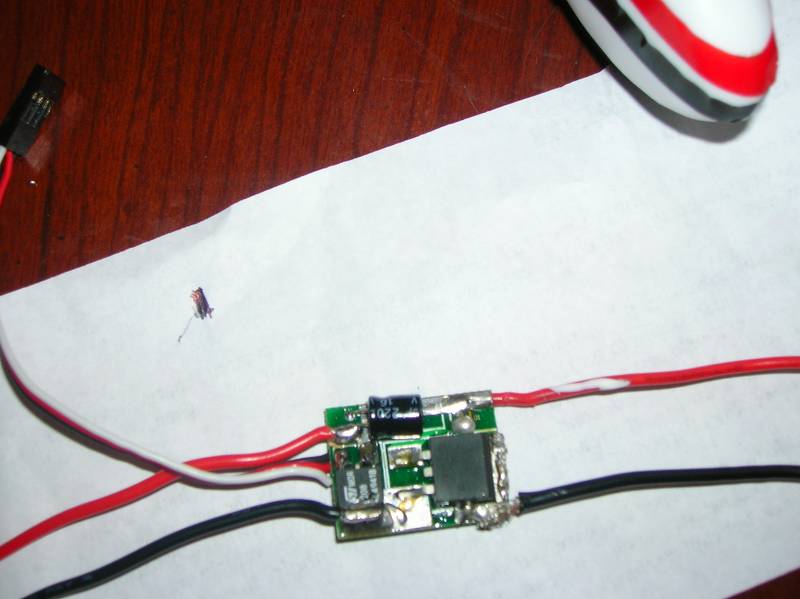

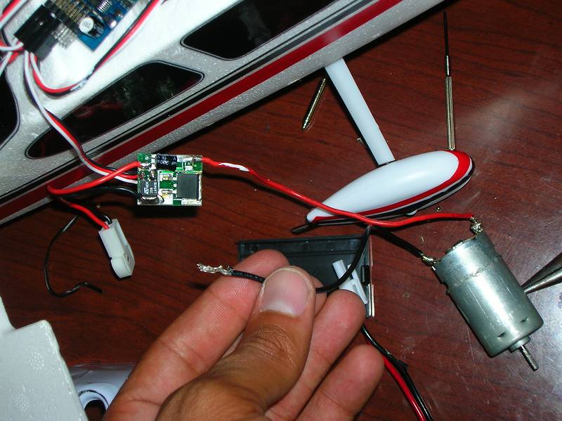

Hey everyone I am new to this rc stuff but i like it a lot. I have a cessna 182 from art-tech and I crashed it. I had to get a new engine and the black wire came off of the speed control or the ESC. I took the wrapping off of the esc and now I need to find out where the black wire goes. Enclosed is a picture of what it looks like. ANy help is appreciated. Talk to you all soon.

It looks like it should be soldered to the edge of the board next the the chip.
Take a voltmeter and see if you get voltage between the red wire and that area when you throttle up.

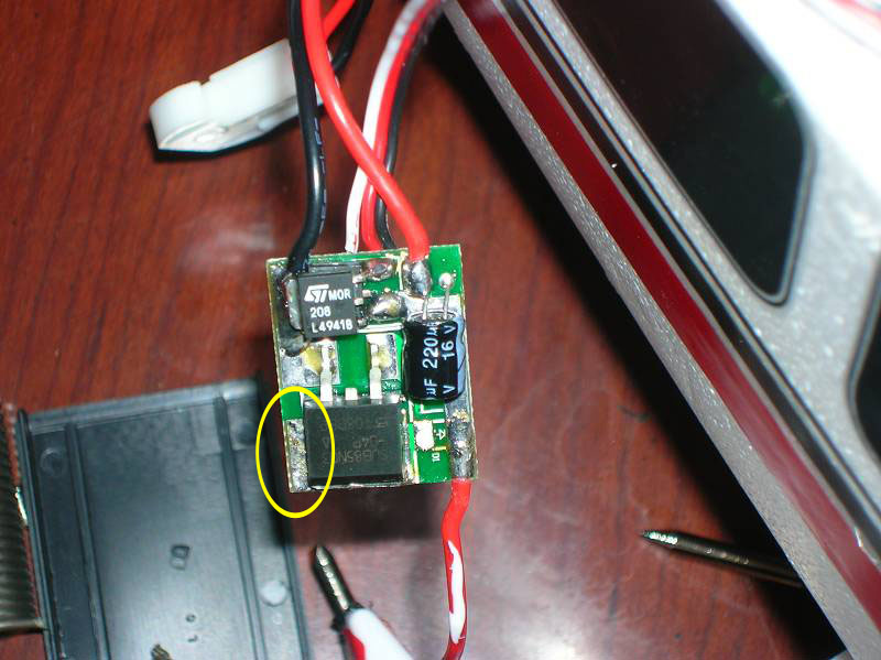

Like Missileman said, and based on the 2nd picture, it looks like it goes here:

Hey this is Stew again, I tried soldering as you said and this is what I got. I connected the battery and the power just ran, I didnt have no throttle control, what should I do?? Please somebody help me!! I need your expertise, the speed control or BEC is really bogging me down.
