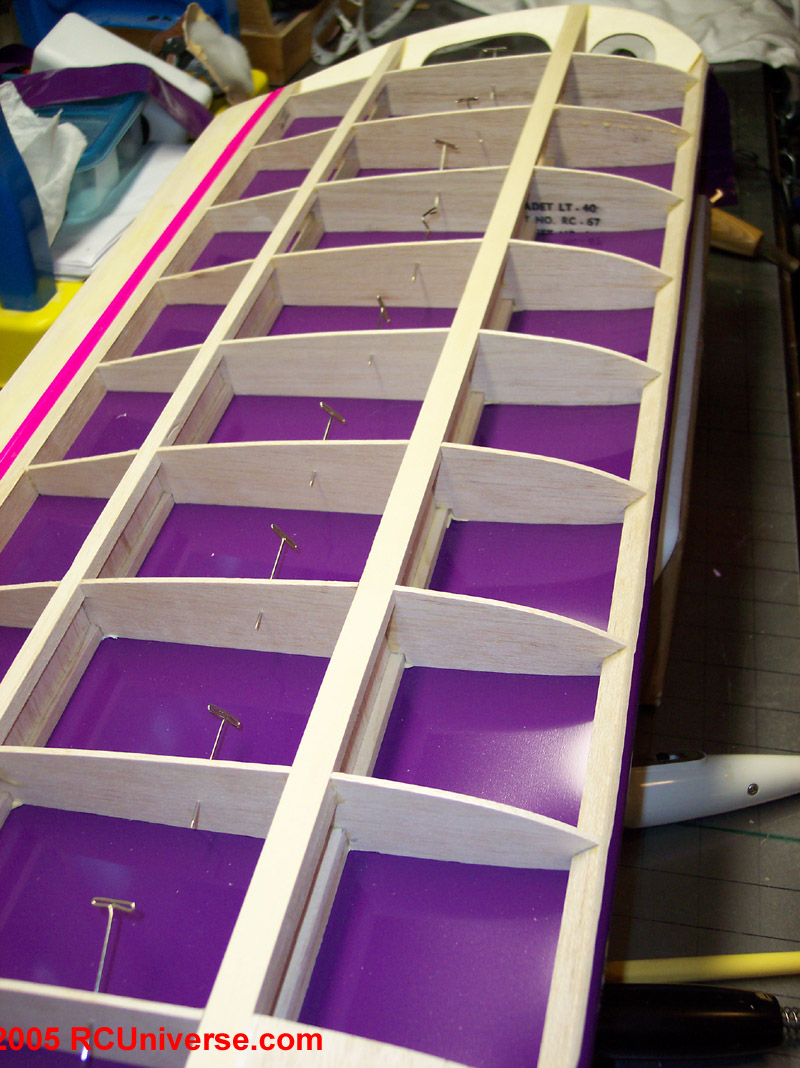

Open bay structures also must be spotlessly clean. Make every attempt to get the covering as wrinkle free as possible BEFORE heating/shrinking. Carefully smooth the material without bunching, and tack securely around the periphery of the open structure, before you try and shrink the material. Keep in mind that the more "shrink" you put in...the more that can come back out later.

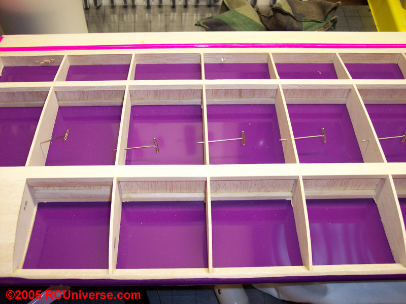

I totally agree with Bruce here. If the covering is completely shrunk before you start adhering it to the structure it will help keep the covering tight in hot weather. But there is another HUGE cause of loose covering that most people completely miss (including those factory workers assembling ARF's), and that is open bay structures. I'm talking about open bays in wings, open areas in stick built tail sections, or any other open area that will be covered up by covering. The problem here these bays are completely sealed and air trapped inside the structure has no where to go. So when you place the covering over the bay you completely seal that area in. As you heat the covering to shrink it the air inside structure expands which pushes out against the covering. The covering will shrink around the bubble of heated air. When the heat is removed the air inside contracts back down and now the covering has slack in it. This slack allows wrinkles to form later on. So how to you avoid this?? Simple, ensure that a structure has a path for air to escape from it. It's as simple as just sticking a pin through the side walls of that area. Keep doing this so until there is a route for air to pass from the outside of the structure to all internal areas. If you look at the attached pictures you will see how I prepared the wing on this LT-40 for covering. I used T-pins to create air vents in all of the internal areas of the wings. I made sure that there was a path for air to vent into all of the internal areas of the wing.

The cause of the MAJORITY of wrinkles is trapped air.
1st. As several others have stated, make sure the surfaces are free from any dust, dirt, etc.
2nd. When doing sheeted surfaces, start from the middle and work your way out to the edges WHILE PULLING ON THE COVERING (keep a CONSTANT tension on the covering while ironing it down.
3rd. (IMHO, the most important) On open bay areas AND built up parts, make sure air can circulate between the bays (holes through the ribs insure this) AND, if the part is completely sealed (ailerons, flaps, rudders, elevators, etc), AFTER the part is completely covered drill a 1/16" - 3/32" hole in an inconspicuous spot (normally along the hinge edge ) all the way through to the bay area to allow any build up of air to escape.
This will take care of 99.5% of the wrinkling problems.
