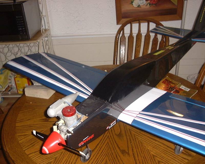

i built the tiger 60 kit,with the tricycle gear.balanced it upside down and it still came out a little tale heavy.i think as said here because of the plywood fuse that is why they are heavy.i put in an asp 90 size motor.i might convert it to a tale dragger.i did not have to add any nose weight just move things around a bit in the radio compartment.few photos of it
ID:	516593   Click image for larger version
