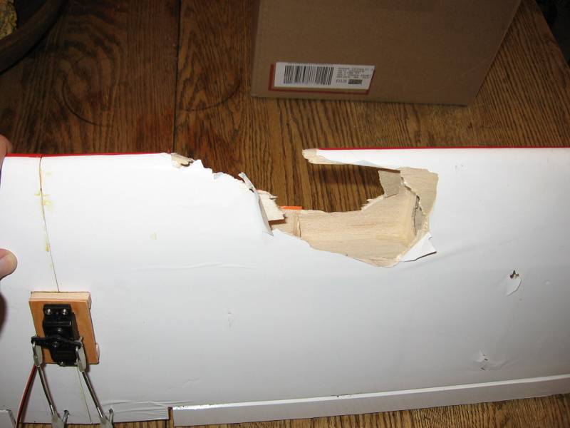

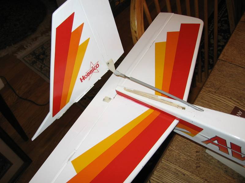

I had a slight altercation with a bush. It called my mother a nasty name, so I flew my plane into it. Unfortunately, my plane suffered more damage than it did.
Damage isn't so bad. A couple of cuts of balsa and some monokote and it should be fine. Fortunately, it was a bush and not a tree. Kind of cushioned the landing.

that was def. one mean nasty bush [>:] ive hit tree branches before and only had a 1 inch whole in the front of the wing on both sides... that was a real evil bush! when you go to the flying field next time ask the club if they can remove it, bring a shovel/cutters and remove it, bushes shouldnt be that close anyways will save you lots of time. hopefully you can remove the bush but if not youll have to avoid it next time
as for the repairs on the wing im sure it can be done, id check the rest of the structure, etc...and see if you dont have any hairline cracks or anything else to. from the looks of the damage it must of been at somewhat of a highspeed? now for fixing the wing up, measure the pieces that are used....main leading edge spar, sub-leading edge spar, 1/16" balsa sheeting covering...and monokote covering or something along those lines then sand the rough edges and match the new pieces to fit perfectly/pretty close and glue them in. id pull back the covering around the spots so the ca doesnt glue the covering down. then reshape the main leading edge and recover and wahlllaaaaaaaa new wing
i havent done to much tail repair so ill let someone else take a stab at that. good luck and remember its like puzzle/jigsaw building, it will fly no matter what you do, just make sure the airfoil in the new spot matches the rest, then youll be fine

well your not the first to be bush wacked har har har. thats the mantra of this hobby crash,fix, repeat.
a good tip for doing wing ribs trace the outline on some cardboard the cut a new rib out then you don't have a glue bomb in your wing when I did about the same thing to my NEXTAR the only thing I reused was the leading edge fit it back in place and used thin CA to glue it back in, then like David suggested check for any joints that may have loosened up and thin CA them then re-cover the repair and patch the holes with wt. covering no need to do the whole wing unless you want to.
the tail thats a snap,what you could use to keep it light is CA or what might be better is Tite-Bond wood glue stuff is bullet proof and not as heavy as epoxy just refit the joint carefully and check for 90o angle then tape it in place to dry trainers are for crashing

For re-attaching the tail, use 30 minute epoxy, not carpenters glue. You need the extra strength of the epoxy. Also add some 1/4 X 1/4 triangular doublers on both sides of the tail (taper the doublers at both ends for aerodynamic purposes) when you re-attach it. There is a lot of stress on the tail and you don't want that to fail in flight.
Hogflyer

ORIGINAL: e-flight22
Hehe, yeah, almost full speed. I am lucky that bush was there. Otherwise my plane and definitely my engine would have been toast. I'm going to thank that bush every time I go to the field. That's now my lucky bush!
Thanks for the tips and replies. I'm going to pick up some Monokote, an iron and some balsa wood at the LHS tomorrow or the next day.
