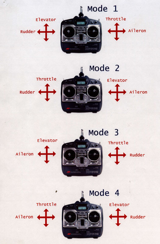

what is the difference between mode 1 and mode 2 is it just the way the sticks are layed out???

Yep. And the ratchets need to be adjusted.
Left stick Right stick
up/down left/right up/down left/right
Mode 1 elevator rudder throttle aileron
Mode 2 throttle rudder elevator aileron
Mode 3 elevator aileron throttle rudder
Mode 4 throttle aileron elevator rudder

ORIGINAL: JR16
Ken

oops I was wrong I dont fly 1 and 2 , I fly 2 and 4...Rog
