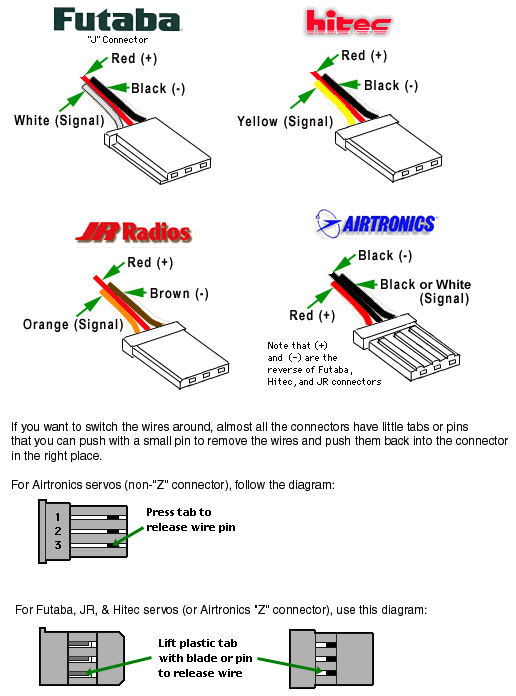

Just FYI,
You can use ANY servos you want with any rx you want. Just make sure they line-up correctly. Ken will be along soon with a very descriptive graphic which alliterates this very well. (Don't let me down, Ken).

ORIGINAL: agexpert
Ask and ye shall receive!!!!!
Ken

Ken: Thank you for that diagram. It's the first time I've seen it and I did not know the difference between vendors and what wire did what.
Thank You, Printed it and put it in my "tips" manual.
